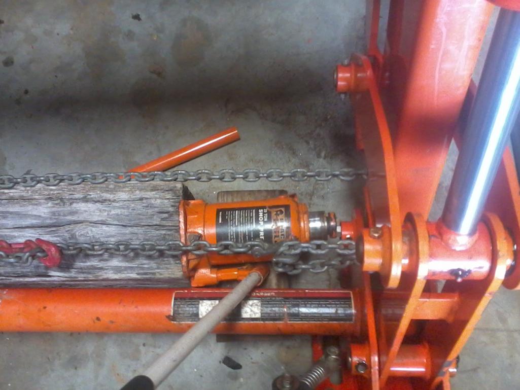

i'd use a 12 ton bottle jack and press it out. you can chain the opposite sides together so you don't spread the frame. a 4x6 post to block the jack to reach the other side.
Once you have tension on the pin soak it with penetrating oil or diesel fuel or a light weight synthetic oil. Now don't hit the pin but hit the outside of frame towards the jack.
you might even need a screw binder on the chain to tighten the arms together. If it moves add more lube and pump jack tight again.

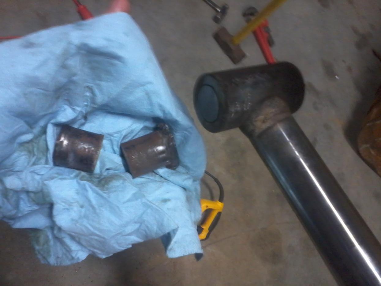

The pins did mushroom some and the reason hammering didn't do any good. I cut one side then took the hammer to open the gap on the other side. Should have taken a block of wood against the rod, but I hit the pin over. Doing this made me have to cut it 3 times to get it out. I'd make a mental note for next time but probably wouldn't remember any way. :(
Pin on the left was cut first and there is a bit of mushrooming on the right side of it

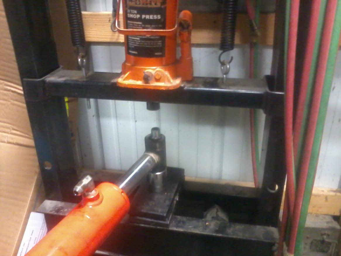

Used a 20 ton press and some sockets and all good. Now just need to clean paint and reinstall
