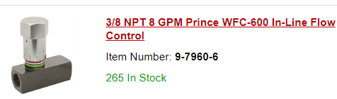

Some bastast boxes do, or just make your own weight.
You can get flow valves here, even with a flow valve you still need more weight on the back.
3/8"
https://www.surpluscenter.com/Hydra...nce-WFC-600-In-Line-Flow-Control-9-7960-6.axd
1/2"
https://www.surpluscenter.com/Brand...nce-WFC-800-In-Line-Flow-Control-9-7960-8.axd
