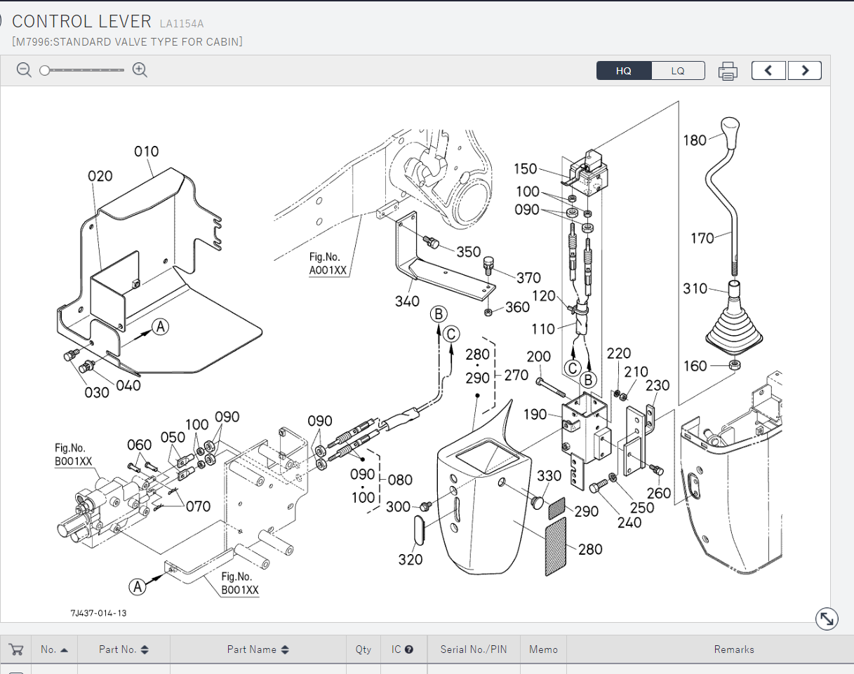

I was looking for a blow up pic of the loader system but can't locate one; anybody have a link and advice?
LA 1154 loader on my M6040

Here's the cab version.
I accidentally locked the loader on the MX6000 a few months ago when moving rocks (or could have been the M6060) by inadvertently knocking the lock tab which is shown in the schematic above on part #150. It took me a few minutes to figure out why the loader wouldn't move. I don't remember if you can curl the bucket or lower the loader when the loader is locked. It's probably not that simple but maybe worth a look.
And here is where to find everything.
It is a broken cable!
Thanks for the diagram, where in the kubota illustrations did you find these pics?
? I need to locate the part number of the control cable so I can order one.

Click that link and agree. Punch in LA1153 in the box, that will open a page, click parts.
