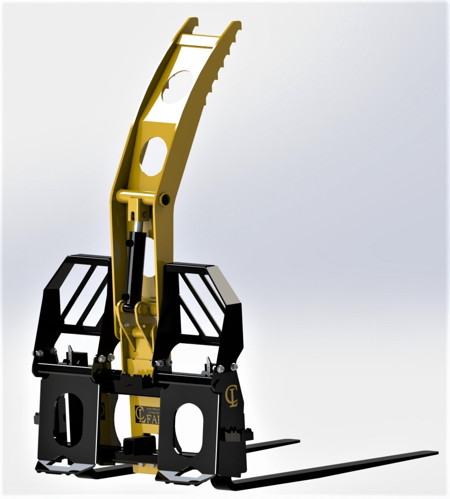

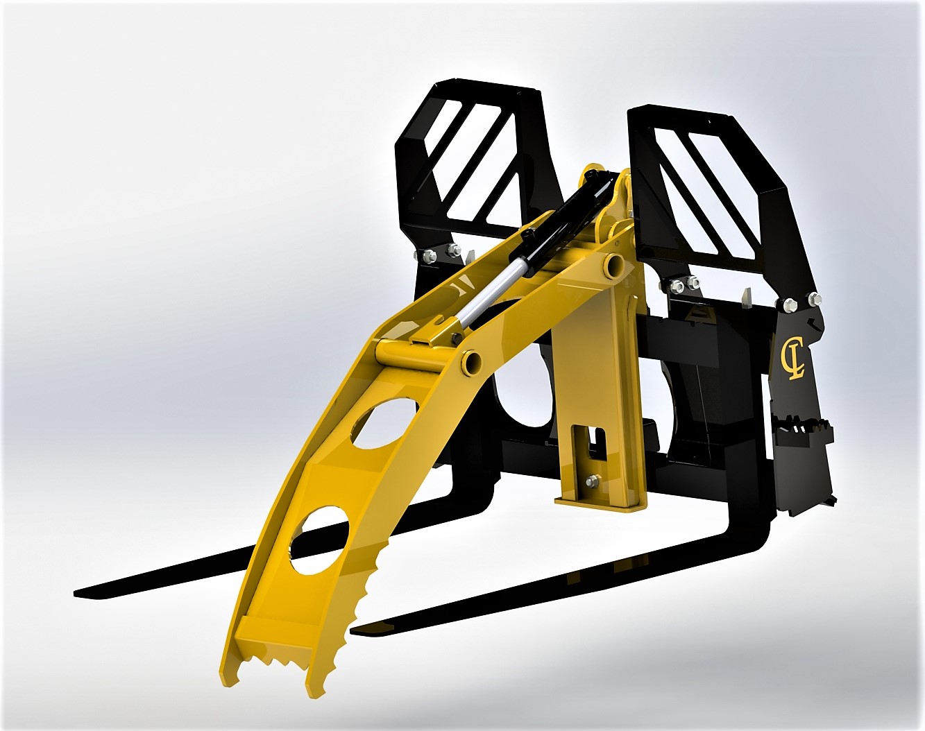

I started building a grapple to fit my pallet fork frame. When I had the plates cut for my backhoe thumb, they somehow got cut double size the first time.
This is the style of grapple I’m building. I plan to make it quick attach by fitting into the 2” receiver on the fork frame.

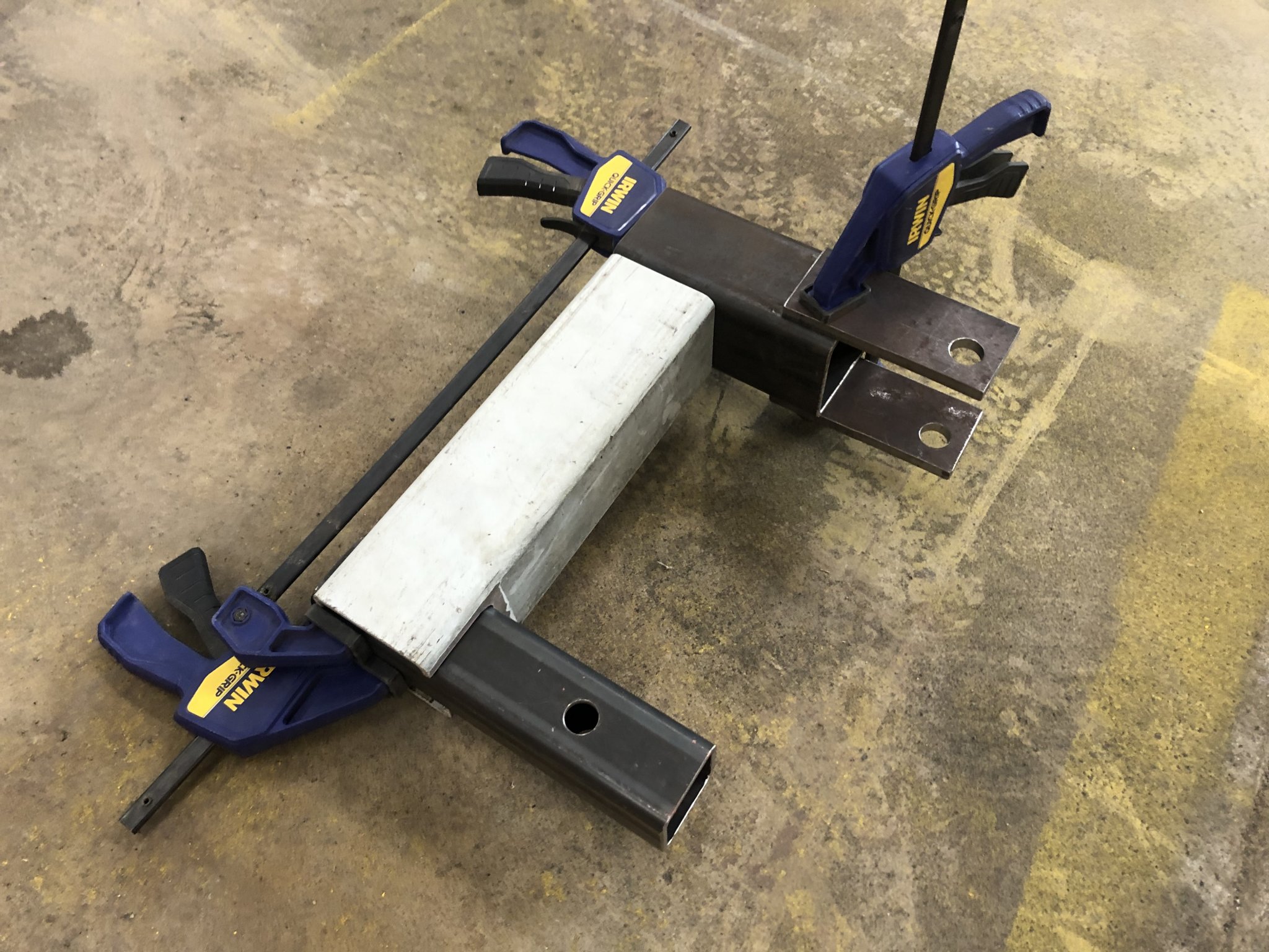

Got most of the pieces cut today. It will slip into the 2” receiver and be pinned to the top link mount. It looks like I need a 12” stroke cylinder.

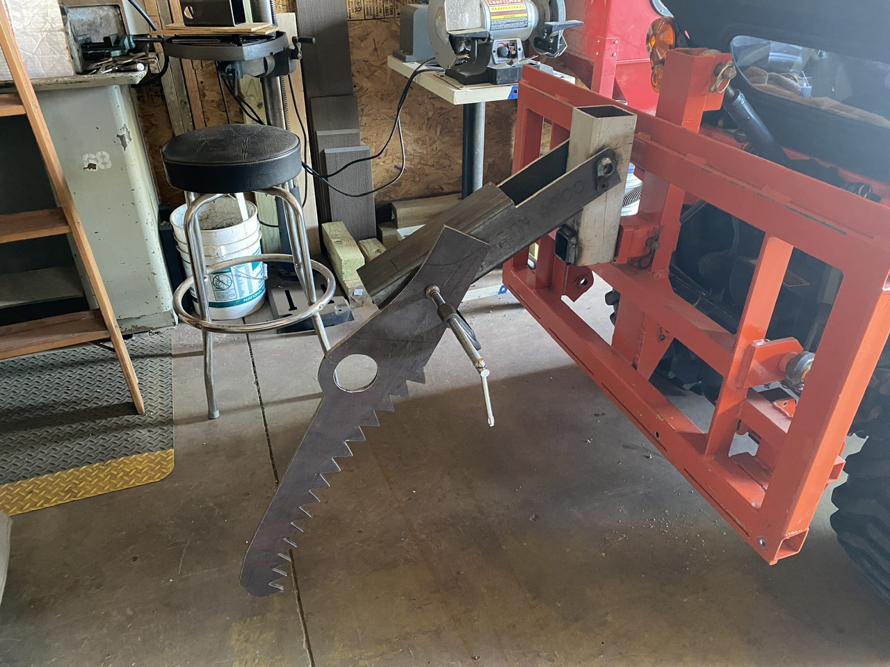

Started working on the grapple again. Moved the pivot point down and got a few pieces welded.
