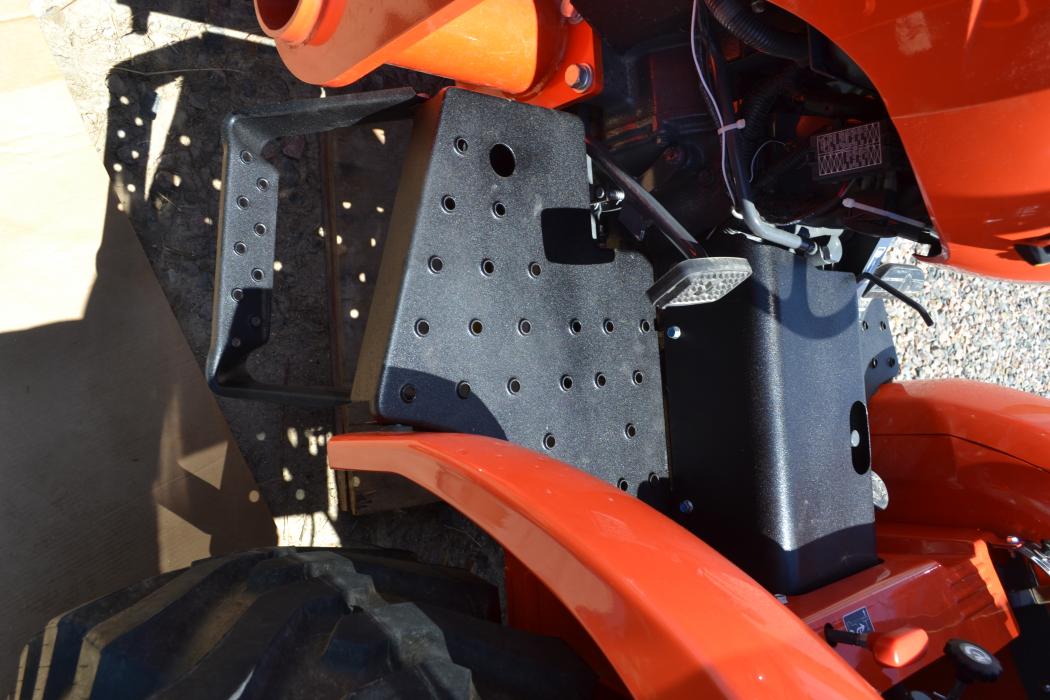

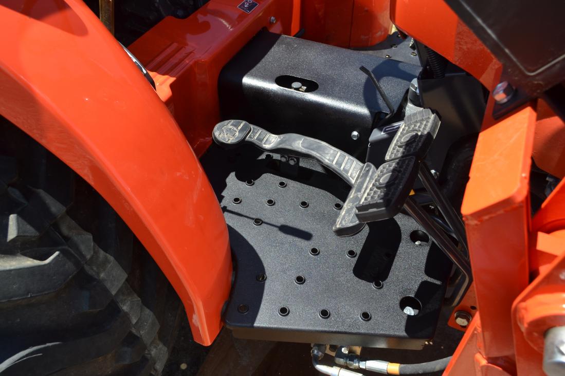

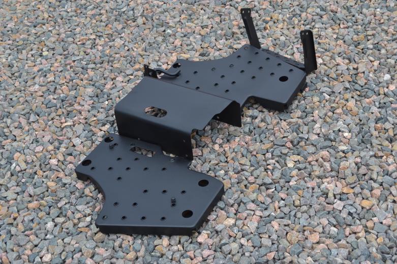

Got the floorboards lined yesterday. Only planned on doing the 2 floor boards and center hump, but the rear panel had to come out for the LH floorboard to come out. The rear panel was a bit of a PITA to get out so I went ahead and had it done too.
They only did the top surfaces, not complete wrap.
The rear panel wedges between the fenders so tight I had them not spray the sides cause I was worried the bolt holes wouldn't line up good if they added material there and made it any tighter of a fit.
I'll try and get some more pics outside when the tractor is clean.
I think the black breaking up the orange looking at the tractor from the side makes it look a little longer, not that it matters.

Wasn't bad at all. The only one that was, was the rear panel - heel kick plate? - whatever it's called. And really it was just a pain because 2 of the bolts on each side were between the tire and fender and I couldn't get my hand back in there to get them out as easy as all the rest.

When I called the guy on the phone quoted me a ballpark of $75-100 range - for what I told him was the floorboards and center hump - "two pieces about 2'x2' square and the other looks like a shoebox".
When I got there with them the owner was the one that met me when I came in the door and said he thought it was just 2 pieces and not 5. I didn't mention the step, and then added in the heel plate, so that was my fault. Anyway, they charged me $160.
Was bummed, but when you think that the phone quote was $100 for 3 pieces = about $33 each, and adding two more took it up another $60, I think it was probably in line.
But then I think that it was only like $450-500 for my whole truck bed....

Number9, I have been inspired by your Line-X floor boards so I have removed mine but am using the self spray on bed liner. I may regret it but time will tell. It is not as course as the Line-X in my truck bed but I think it will work fine. You are correct about the kick plate being a pain but I chose not to coat it. I will post pictures of the panels before I mount them and after I mount them later today. Thank you for the great Idea.
