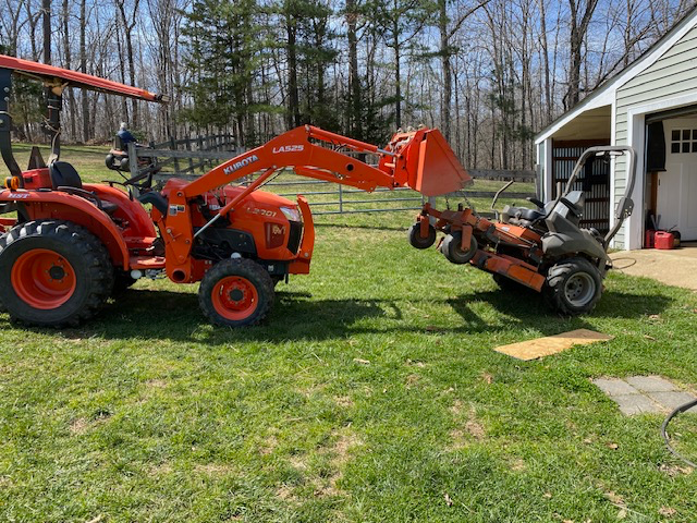

I put a web tie down strap around the front of the ZT mower, and lift with my loader bucket hook, until the tail end of the machine touches the ground.
I then put a jack stand under the front edge of the mower, and lower the mower until it rests on a jack stand.
Easy to then reach under to scrape the mower housing clean, and/or replace the blades.
