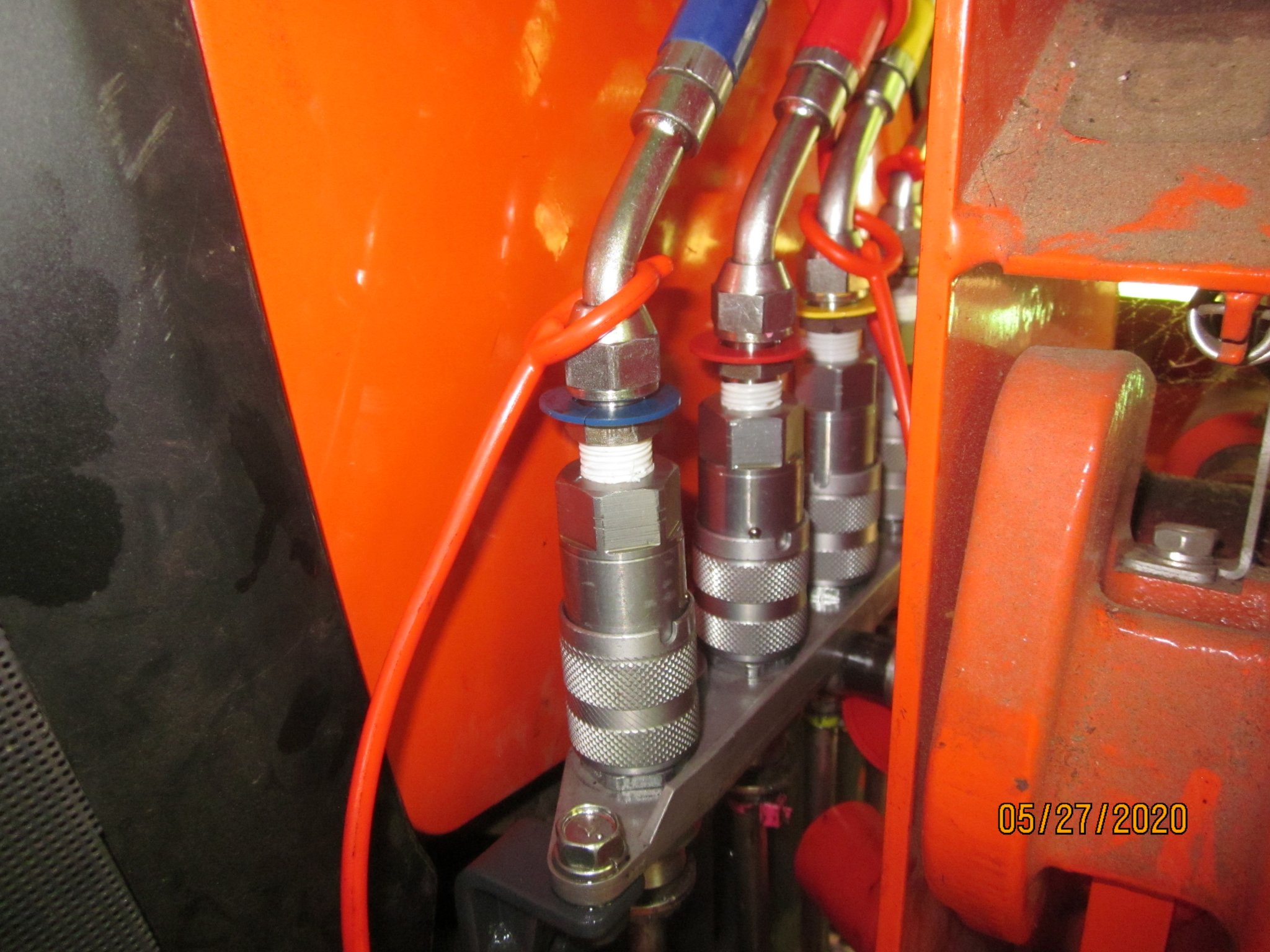

Had my 2380 "repaired" once by the dealer under warranty. Began leaking again shortly there after. The quick coupler design sucks because the single attachment point in the middle of the coupler allows it to rock. Replaced the upper coupler with 4 Summit hydraulics 1/4 NPT flat face female couplers. No need to change the lower males. Also required 4, 3/8 JIC to 1/4 NPT adapters. Hasn't leaked since.

In reference to my previous post. It's not the quick connect device. It continued to leak.
I have all but stopped the leak by holding the nut on the metal hydraulic line while tightening the 22 mm female connected to that through the receiver plate mounted to the tractor. It looks like who ever assembled it didnt tighten them fully. They need to be disassemble and re taped. I think that will take care of it.
