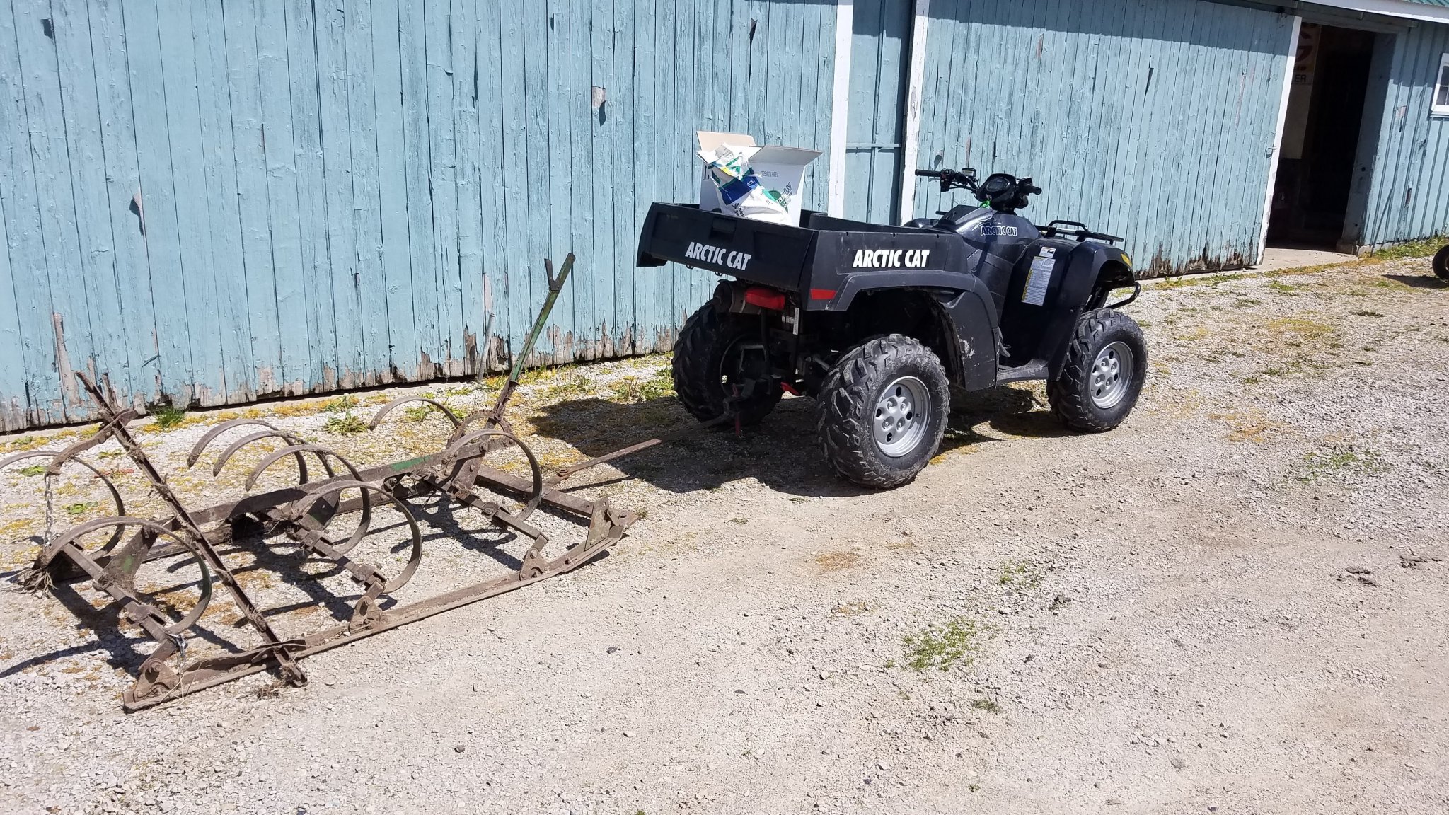

When my wife and I 1st bought our hobby farm we used what we had at the moment for our 50x50 garden. I used my 700cc atv with a spring tooth drag. It worked really nice in the spring but would plug up sometimes with corn stalks in the next spring. It dug deep though.

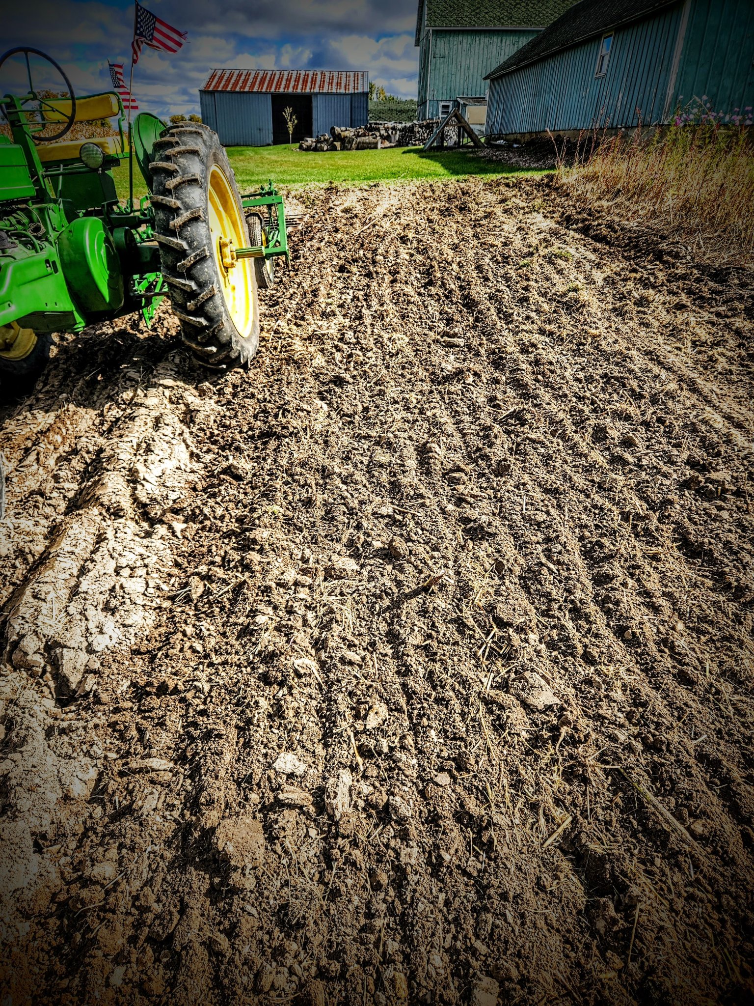

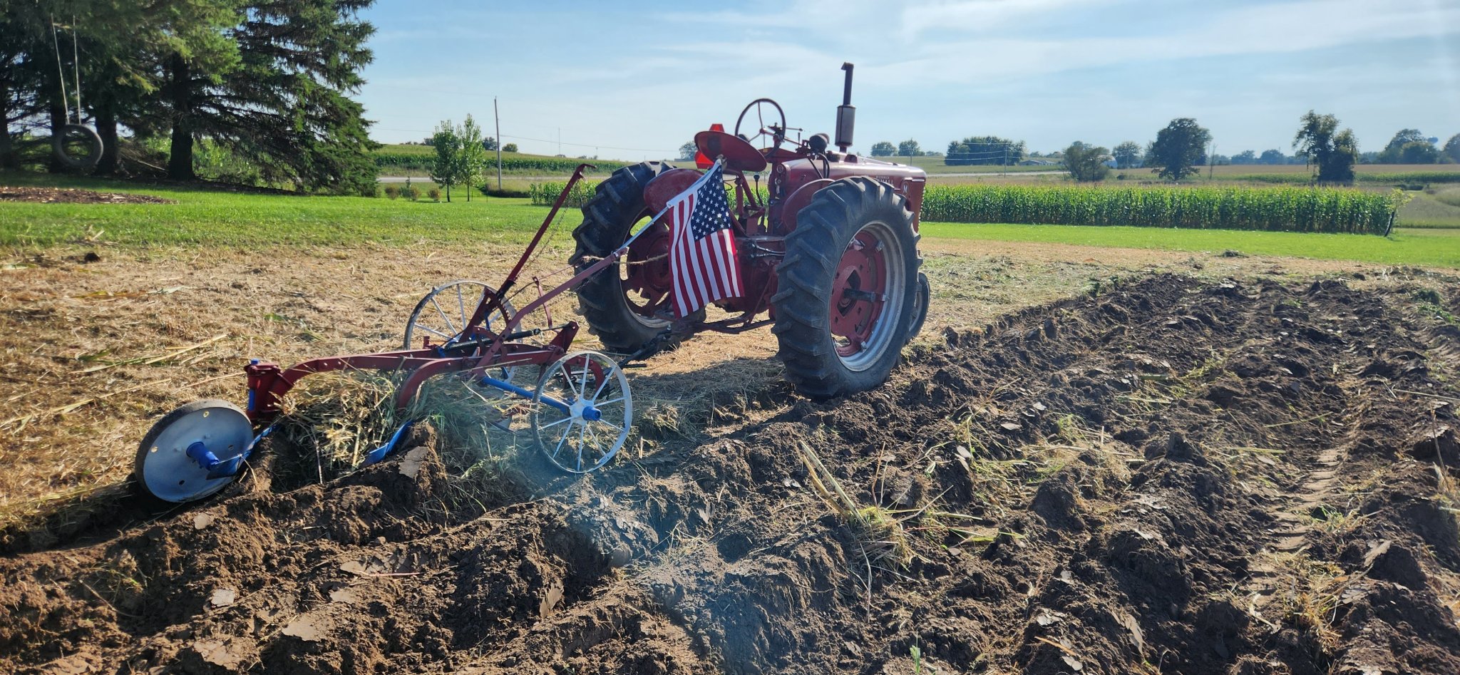

I bought a fence line plow for 100.00. That really turned the soil, buried residue, got rid of the hard pan and up production.

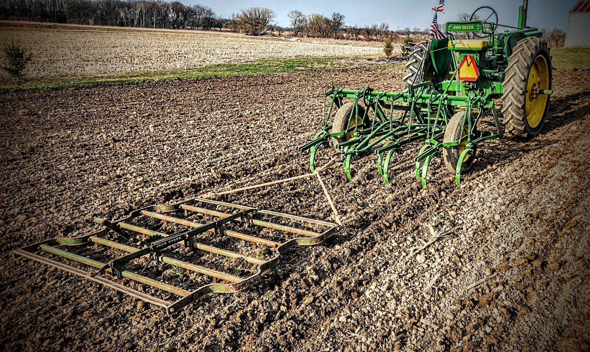

I also bought a field cultivator for 100.00 and pull a drag behind it. It just kind of scratches the grand vs the spring tooth I had.

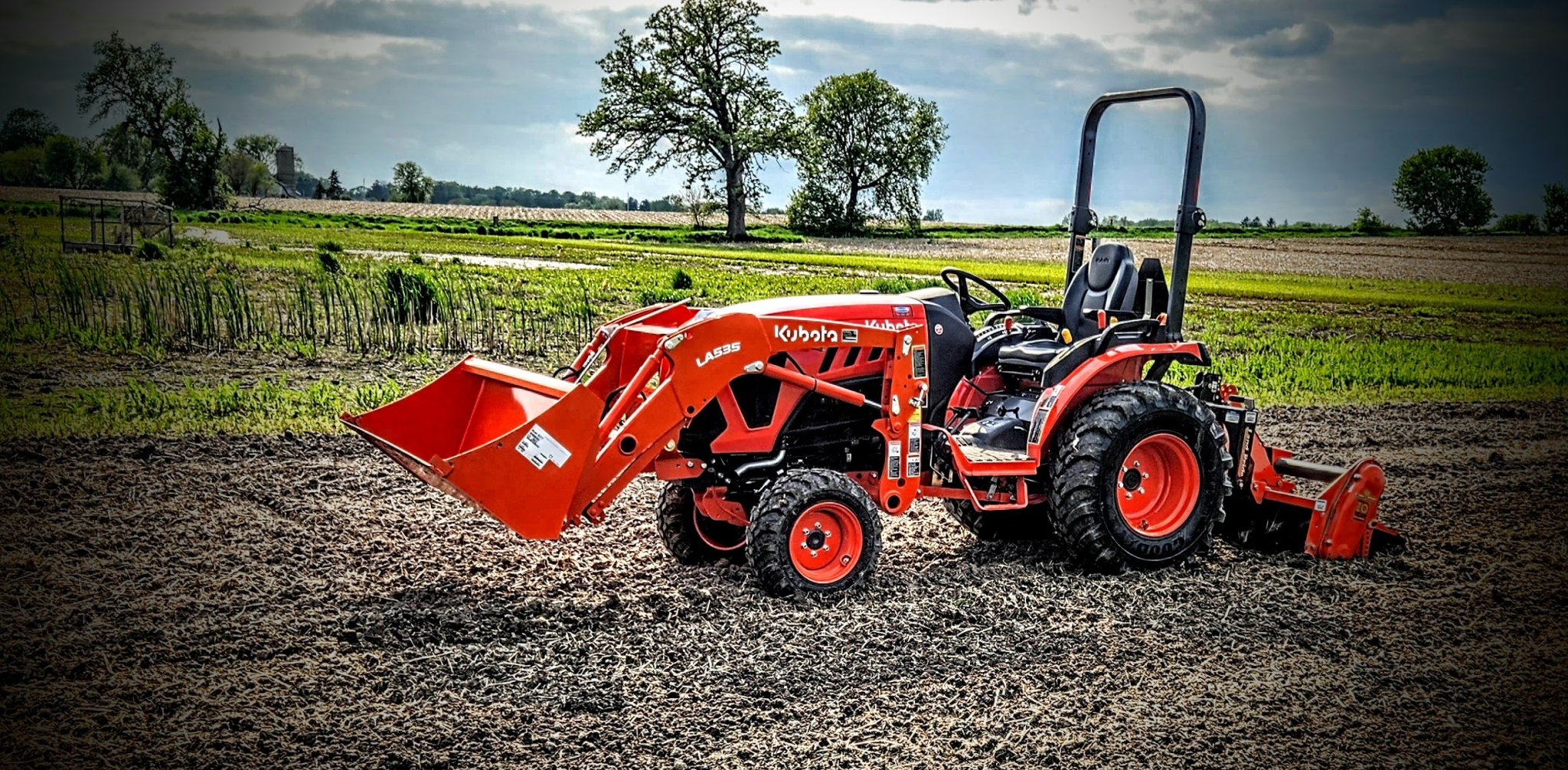

I also have a tiller for the Kubota. It leaves a nice seed bed, but struggles with thick reduce.
