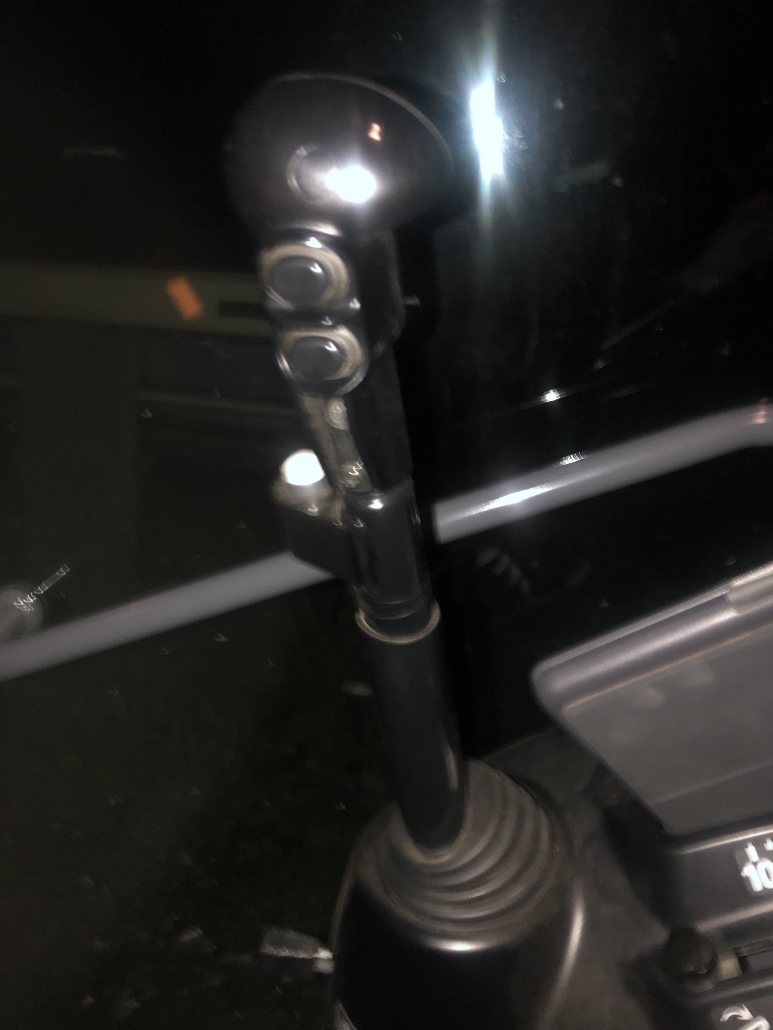

Here is the control that’s on my 3rd function. The green light lights up when it’s on. Sometimes I hit the “on” button with my hand and I don’t see it’s on because it’s hidden from view when I’m in the seat.

I had the same problem so I installed a switch. When the switch is on it lights up.
That looks like a good solution. I have rotated the handle around so the buttons are on the thumb side and that looks like it will work for me. If I still have trouble with it then I will go with the toggle switch that lights when on. Thank you.
