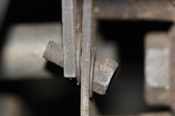

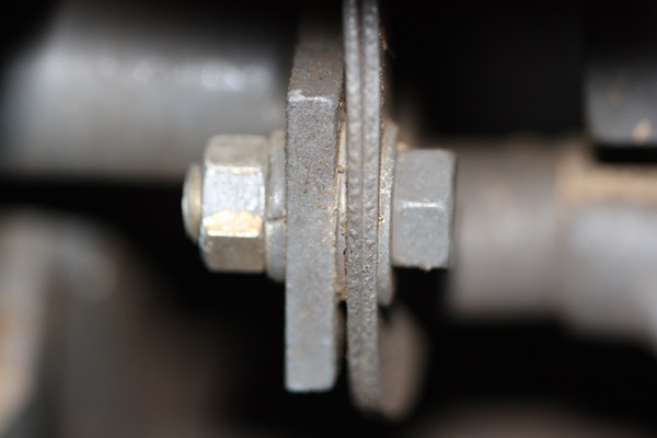

If it ain't one blasted thing it's another! While I had my tractor taken apart to repair a cracked banjo brase, I pressure washed all and did a general inspection. And of course I found something that don't look right. There is no chance that the hydro pump coupler shaft has an eccentric orbit on the back end is there? Two bolts secure the shaft to the coupler and one of the nut-bolt-washer sets is as expected. The bolt holding the other side however, is seriously whop y jawed and does not have a nut on it. What that implies is that the back end of the coupler shaft has "slipped" off center and is making a three inch orbit instead of spinning centered/inline with the engine crankshaft. I would not even question if it is eccentric "by design" except for one thing. It looks like the bolt in discussion was actually cut or machined in some way such that there is a furrow ground into the bolt at a crazy angle; like what a 1/4" grinder disk would cut. And it is C L E A N! Honest it looks machined. The associated washer is also cut almost through from the inside to the outside. Neither the IPL or the WSM addresses the coupler shaft, other than to show it in the drawings.

Which pump, front or side, and you do know a picture would really speed up this process! ;)

That picture is just wear from the two parts it was trying to hold together but the missing nut let the joint move and wear all three parts.
You can replace the bolt easily but you will need to repair or replace the shaft flanges. You may be able to weld a piece of metal to the back of the plates and drill a good round hole through those new blocks. Then you may have to install a longer bolt.
Now that is helpful! Thanks Mr. King. I would have neither thought of the flange holes wearing nor inspected them for same if you had not covered/suggested it. What I think is that I got off very lite. It obviously has been like that for YEARS! I am probably lucky my hydro pump seal and gears has not already exploded out of the pump back like an alien from the chest of a unsuspecting carrier!
