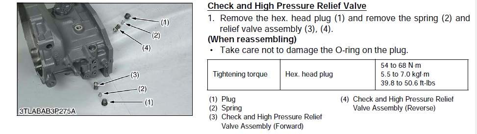

The HP relief valves are shown on WSM pages starting at 3-S89. All you'll be doing is taking them out - with the engine NOT running. When the plug (1) is taken out about 2 or 3 gal of UDT fluid will drain out (have a CLEAN container ready).
Here's an excerpt from WSM page 3-S122 showing that the forward valve comes out the bottom, and reverse comes out the top. Since the forward relief is suspected to be acting up, maybe just take that one out first, checking for debris or something holding it open allowing it to leak by.
Hope this is helpful. Best luck. Dick B.
Thanks for the info. Adds clarity to what I have found so far. I accessed the WSM troubleshooting flowchart for " no forward movement" and the resulting solution was to check the pressure relief valves, as you suggest. I assume that the photo depicts the HST? Is this unit accessed after "splitting the tractor" or are the pressure relief valves accessed from the outside without the necessity of "splitting" the tractor?

If you take a look at the machine under the left side you'll recognize the HST unit right behind the engine. That photo is from a part of the shop manual where everything is shown disassembled for clarity - the machine is in pieces - hopefully yours wont need that.
The high-pressure relief valves are accessible from the outside without splitting the tractor.

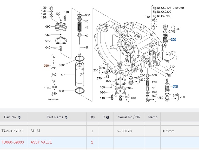

What we're looking for is extra junk in/around the valve bore that could be holding it open. The pressure is high so a tiny metal shaving could be affecting performance. A new valve TD060-59000 costs around $400 so its worth a close look before just replacing one.
Below is a screenshot of the parts page showing the two HP reliefs - parts 200. Notice there's another plug just ahead of the Forward relief - that one is not involved in the swap.
