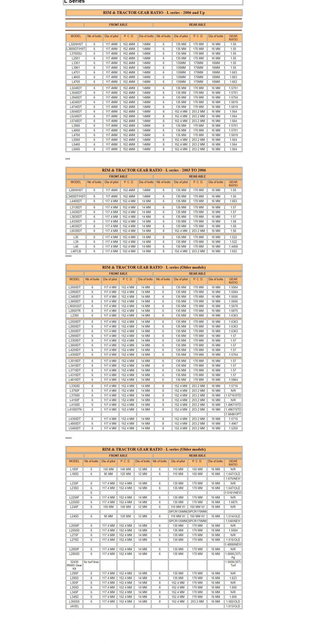

I took the gear ratio from a forum post, as 1.57
Now the turf tyre result is 105.3%, so an ideal lead of 5% on the front tyres. Great at least I know its been driven on decent ratios

My question is can I safely use the ag tyres with an 11% lead, using the mfwd( which is stuck engaged)?
