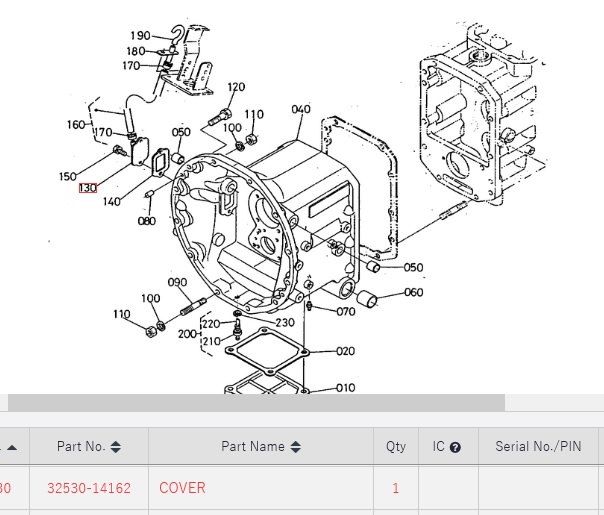

Hey there, thanks so much for reading this. I have a L4150 and the clutch suddenly stopped engaging. The clutch peddle goes all the way down with no resistance. I checked the linkage and it’s good. I greased the zerks. It was scary when it went out. I almost crashed into my truck because the clutch didn’t engage! Thanks so much for any advise.
29,443
5,714
Sounds like you've broken either the pressure plate or the clutch fork.
You're going to need to split it to find out.

I second the throw out bearing fork… check the shaft also.
Must times its not the pressure plate that fails if its not disengaging. Any way to grease bearing or plate to inspect before you split it?
