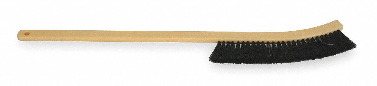

A useful tool is a "radiator brush." Actually for old-fashioned steam radiators in homes. A long thin brush for narrow places.
Handy when you are far away from a hose or the shop compressor.
I have kept various brushes handy for a quick cleaning and they work pretty well, I also usually have a Stihl leaf blower in my truck.
