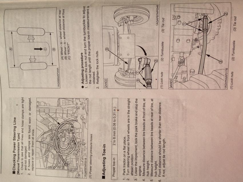

I believe that info is in the manual.
I'll post a pic of it, once I get out to the garage.

I don't think you can adjust camber on a 4x4 tractor.

I didn't think you could adjust the caster and camber on a tractor period. I figure it was a straight solid axle designed to take weight. Its not like tractors travel at a high rate of speed and hit nasty potholes on the interstate and need to be adjusted.

The top of the tire should lean out away from the tractor. In at the bottom, out at the top. Positive camber, this is built into the front axle, no adjustment. I believe you were seeing a tropical delusion. ;)
