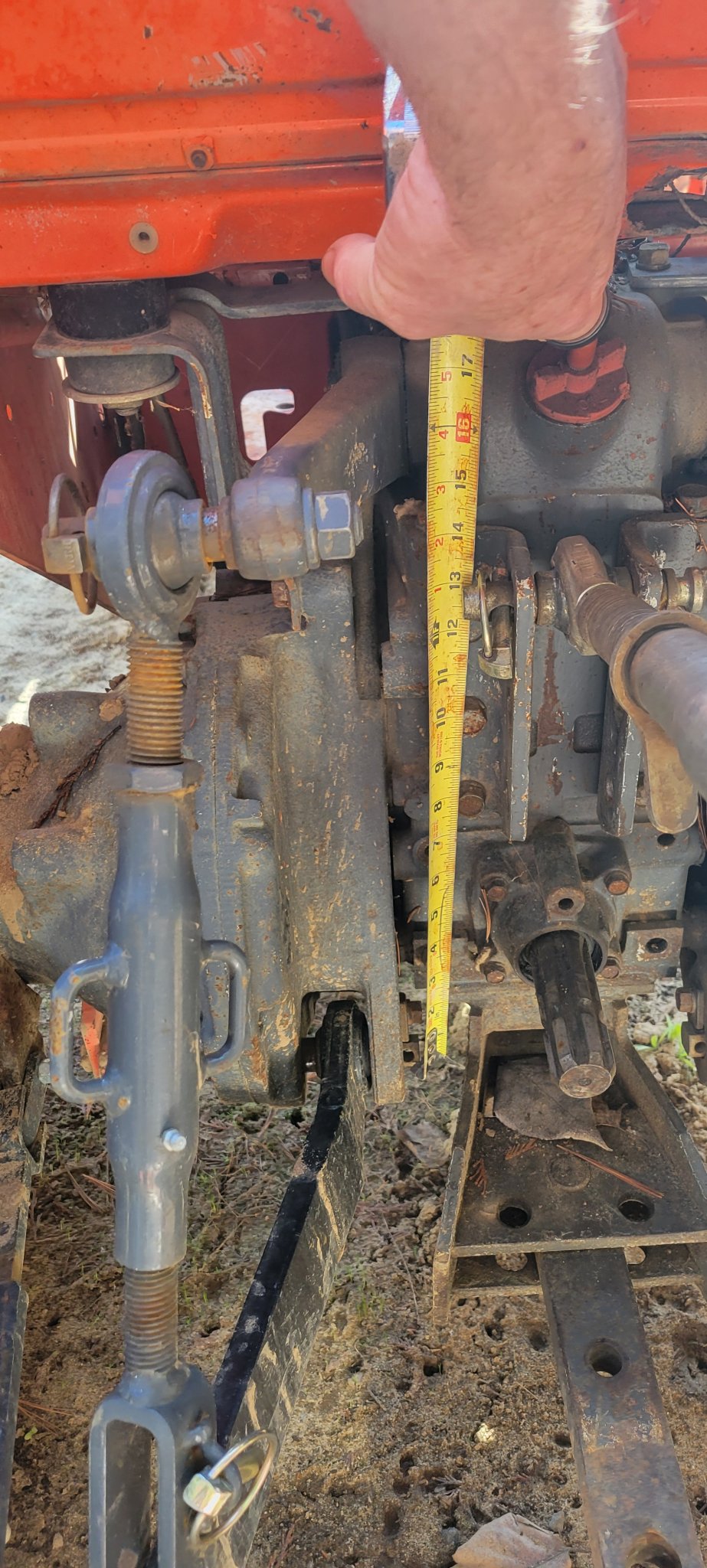

Give me the distance from the center of the rock shaft to the center of the lift arm pins.
Also give me a couple more pictures below the axle, it looks like your missing some other parts you will need.

I will get this pic and measurement tomorrow. Yeah, I saw they weren’t attached when I was looking to buy. I’m currently trying to get it all back together. Thanks for the warning though, I appreciate it.

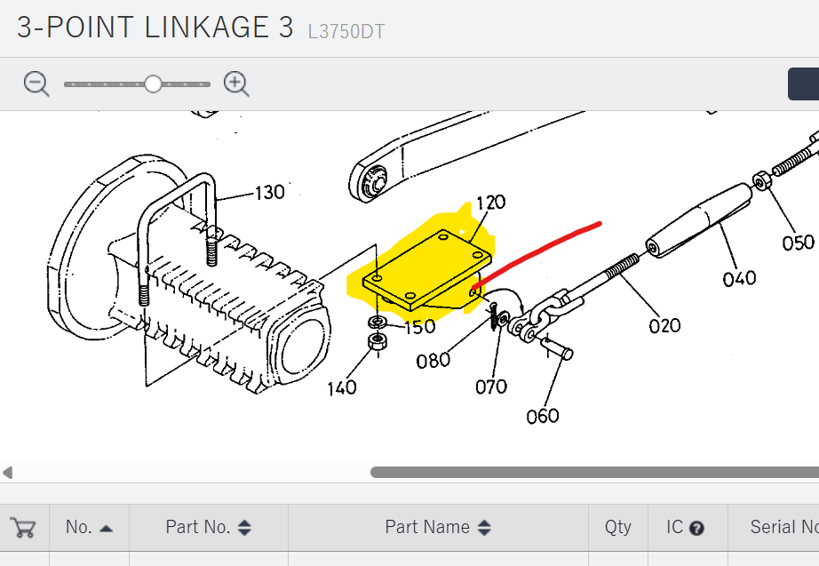

You need these plates (yellow), the tab and hole on the bottom (red) is critical as it needs to line up with the pin for the lower arms, they are for the sway links.
If they don't line up with the link arm pin the dimension of the sway links change as you lift it, and that's bad.
