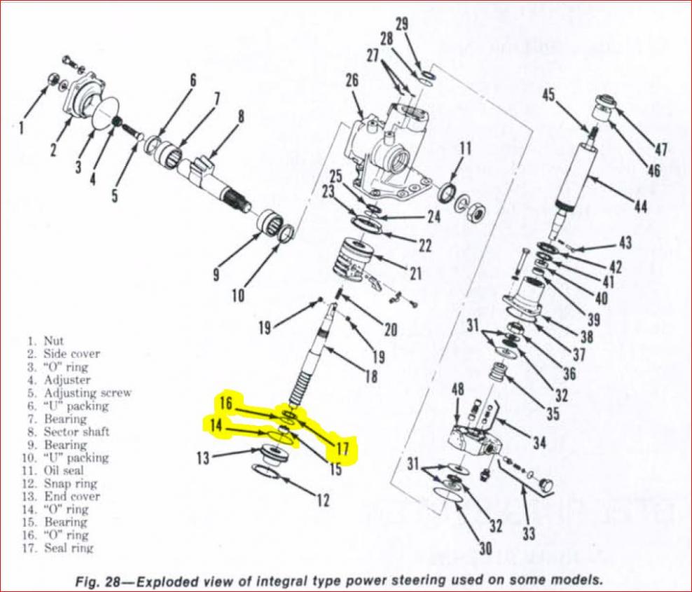

In the L355 WSM they show a teflon ring around the outside of the #14 o-ring.
Do you by chance have the rest of the "Figure 28" parts & numbers?
Any idea whether the L355 and L345 use the same power steering unit?
Thanks again, Dick B

Update:
Took the steering box off and turned it over, revealing the source of the leak.
The area around parts 12, 13, 14 is severely corroded. The ball screw plug is still tightly seized in place
but the snap ring groove is partly corroded away so some of the ring is no longer retained.
The fluid is seeping out where the ring groove is bad. The o-ring groove is likely bad too.
The plan is to seal the leaking area.........edit
1/21 update: Hey Wolfman - you were exactly right - all it really needed was a new o-ring (and some cleaning up.
I decided to try to get the plug out - I ground some flats on the crown to grab it by and got it loose.
The snap ring groove had built up with rust and pushed the snap ring partway out. The o-ring was shot.
With the ring grooves cleaned up it all fit back together well - no epoxy or retainer plate needed. Life is good.
