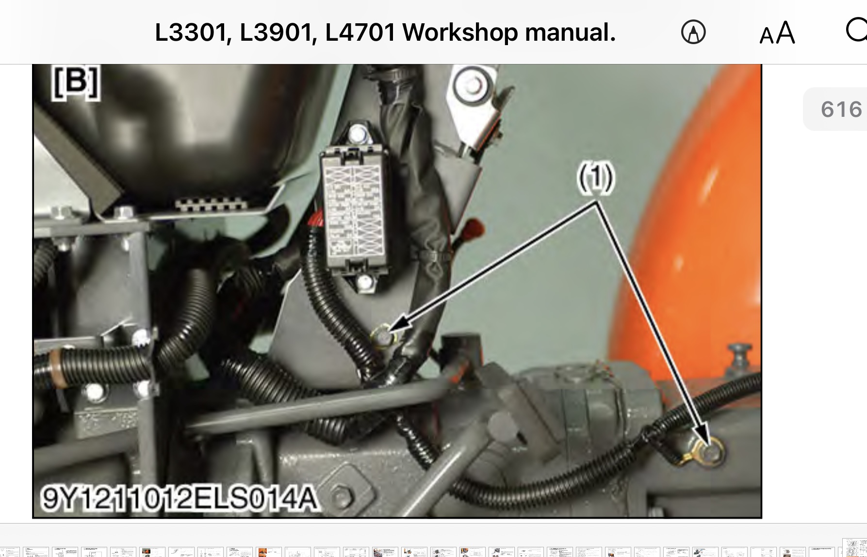

Have you checked/cleaned/reinstalled these ground cables?

Thx. Have done so.
