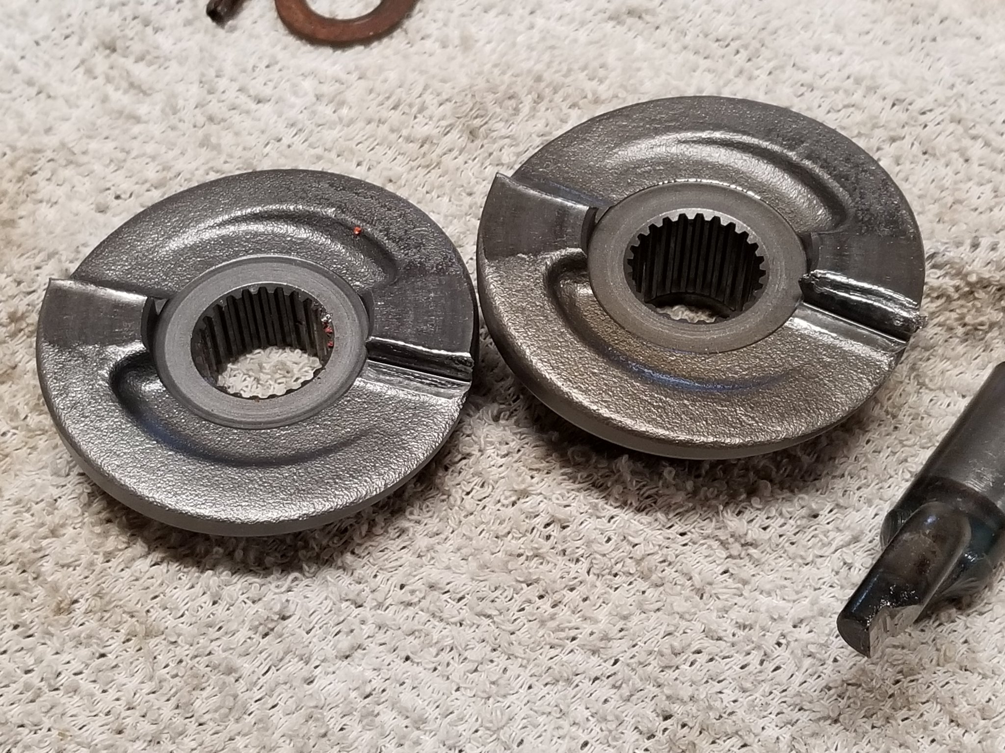

I have about 4 hours in tear down. Took off way more than I needed to but it provided better access. My original idea was to leave the hoe sub frame on and just disconnect from the loader frame. Then use that to rest on the dolly. But there was just not enough space for the "U" shape to clear the bottom of the loader posts. Probably less than 1/8".
Ordering parts this morning. You can see the engagement arm is worn also.

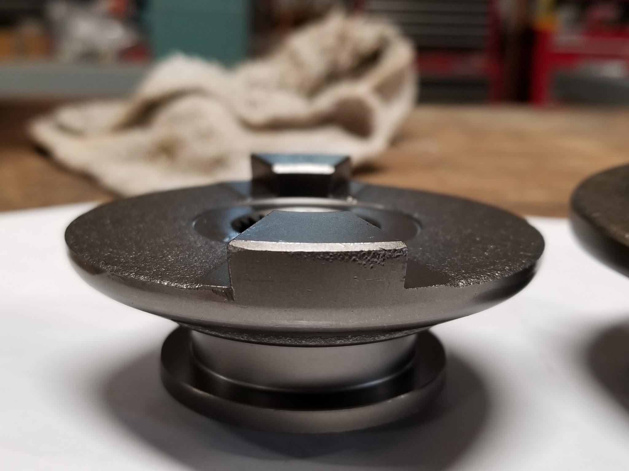

Parts are in. As Lugbolt mentioned they now have a negative angle to keep them from slipping. Hoping to get it back together this weekend.

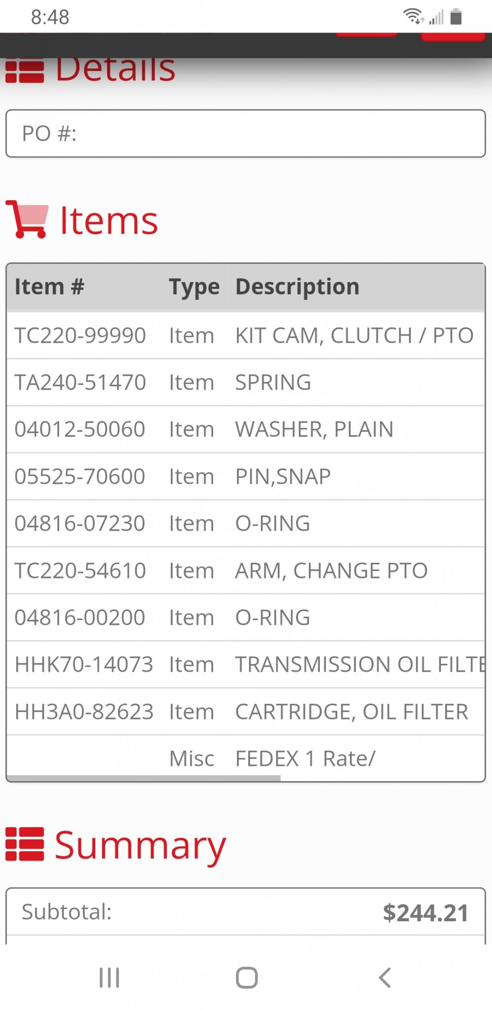

What else besides the CAMS did you have to purchase... I need to buy a set to keep on hand.
I wonder if the old CAMS could have been machined with a new face?
Here is my parts list. The cam kit comes with the front and rear cams and the bolt to secure the front cam on the shaft. Parts 70, 100 and 130 on the diagram. To be safe I'm also changing the spring in front, 80.
The engagement arm, number
10 was worn so I replaced that also.
Orings for the suction tube and engagement arm just because I'd hate have to go back and do it after the system was full of fluid.
I'm at 400 hours so it was time for fluid and filter change. If I wasn't near at the fluid change I probably would have reused the fluid and just changed filters.

I do believe that the cams could be reworked fairly easy. I may set them up in the mill one day see how they come out. I'd probably mill off the ramps and make them like the updated part.

About milling; I would want to keep the overriding ramps (to keep that feature). I guess I'm wondering with these new "locking" CAMS, when the mower momentum is faster than the engine (throttling down) where does the excess mower momentum get dissipated in to? Does it go through the PTO to the motor?
The forces from my chipper's flywheel (especially when I get off the tractor without flipping the seat up). I assume with these locking CAMS, that power has to push on the engine? Or is there an over riding feature in those tractors with the locking CAMS?
Anyone with one of these Standard L models should be able to tell us.... except for those with the over running “Ratcheting" CAMS...

I've been following this just out of interest. Looks like Kubota did away with the overrunning clutch on the new parts. I don't see the need for it with HST - you can still control the tractor speed with the treadle.
By the lack of wear on the lower part of the coupling ramps, I'd say the old one wasn't fully engaging. Probably good you replaced the engagement arm.

I've run many tractors over the years and this is the only one that has had this type of over run slipper. Yes the implement, like a chipper or rotary cutter, will push the engine. But it's always been my practice to bring the engine rpm down slowly and disengage the pto as soon as I can. With the L2800HST it's even easier. I cut the throttle and push in the clutch at the same time. Then while the clutch is depressed I disengage the pto.
