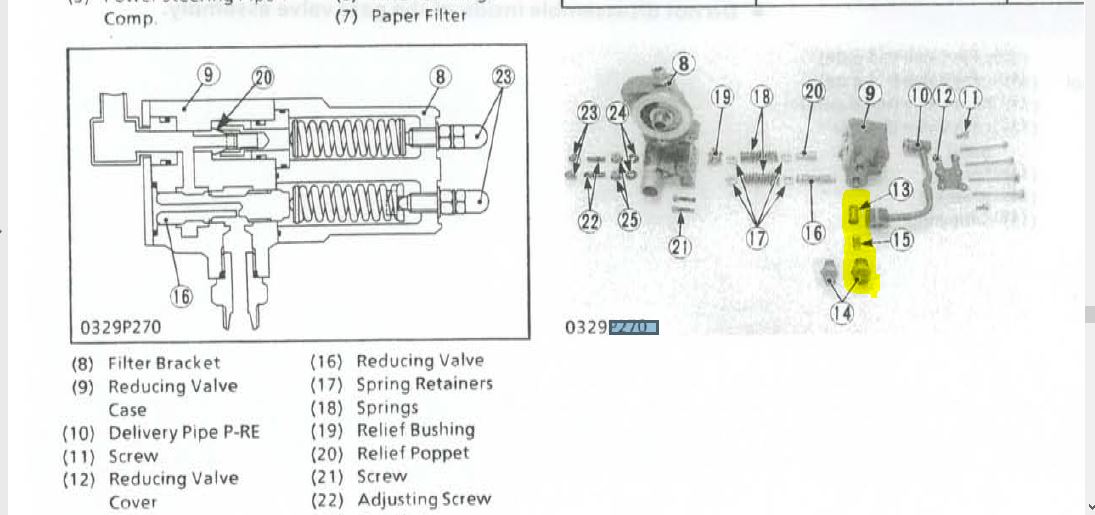

This exploded parts diagram may help if the location looks like the one in the red box.
#180 is poppet
#190 is spring
#200 is adjusting screw
#210 is nut
#220 is O ring
Dave

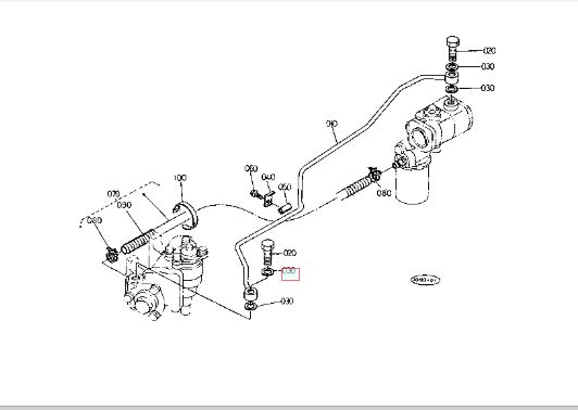

I certainly appreciate all of your input on this, one question though.
It seems the pics and drawings you are posting is of the steering box, the valve I am dealing with is from a block under/near the pump. The fitting/valve in question has one end of a pressure line screwed into it, the other end does go to the steering box, but the end I am dealing with is on a block, maybe a junction block?, near the steering/hydro pump.
I am not sure if we are all the same page here, will stop after work tomorrow and study the situation so we are not chasing our tails.

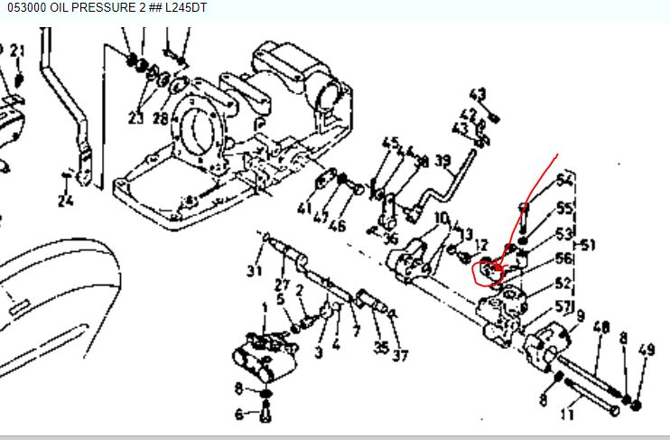

I'll bet dollars to doughnuts that your Brother has a GST not a DT, because a DT has the PS line come out the top of the pump like this.
Where a GST has it come out the bottom of a filter housing like this:
Now it you note they do not show any valve in the fitting???
Well a little more digging and I do find mention of it in the WSM:
So fitting, spring, and point up on the valve into the filter housing.

Wolfman, thanks for the pics. I've taken the one you sent and highlighted the area in red that I believe is were our line screws in, the local dealers have been no help so far.
You gentlemen here have helped more than the dealers have.
It seems that no pictures or manuals I can find show exactly what we need.
Myself am not above putting this thing in and trying like you said, just didn't want to cause any collateral damage.
