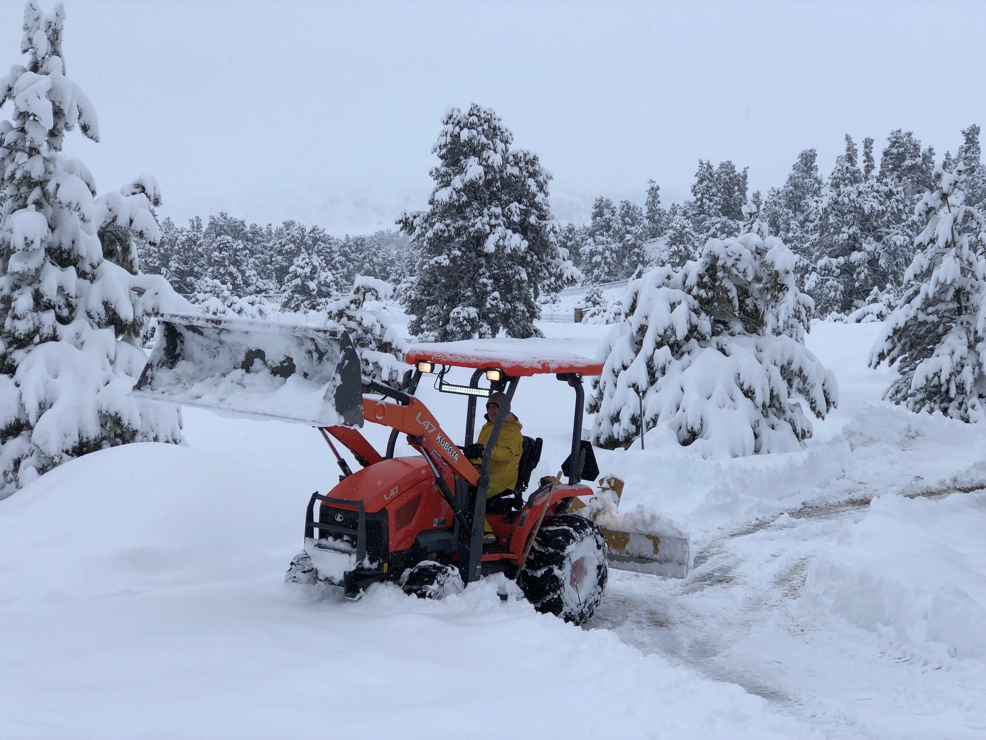

Frazier Park Ca
You will prob push snow going down hill, I live at 5500', and my Regens are very seldom and I just run the tractor while it does at a higher rpm, "Non issue".
