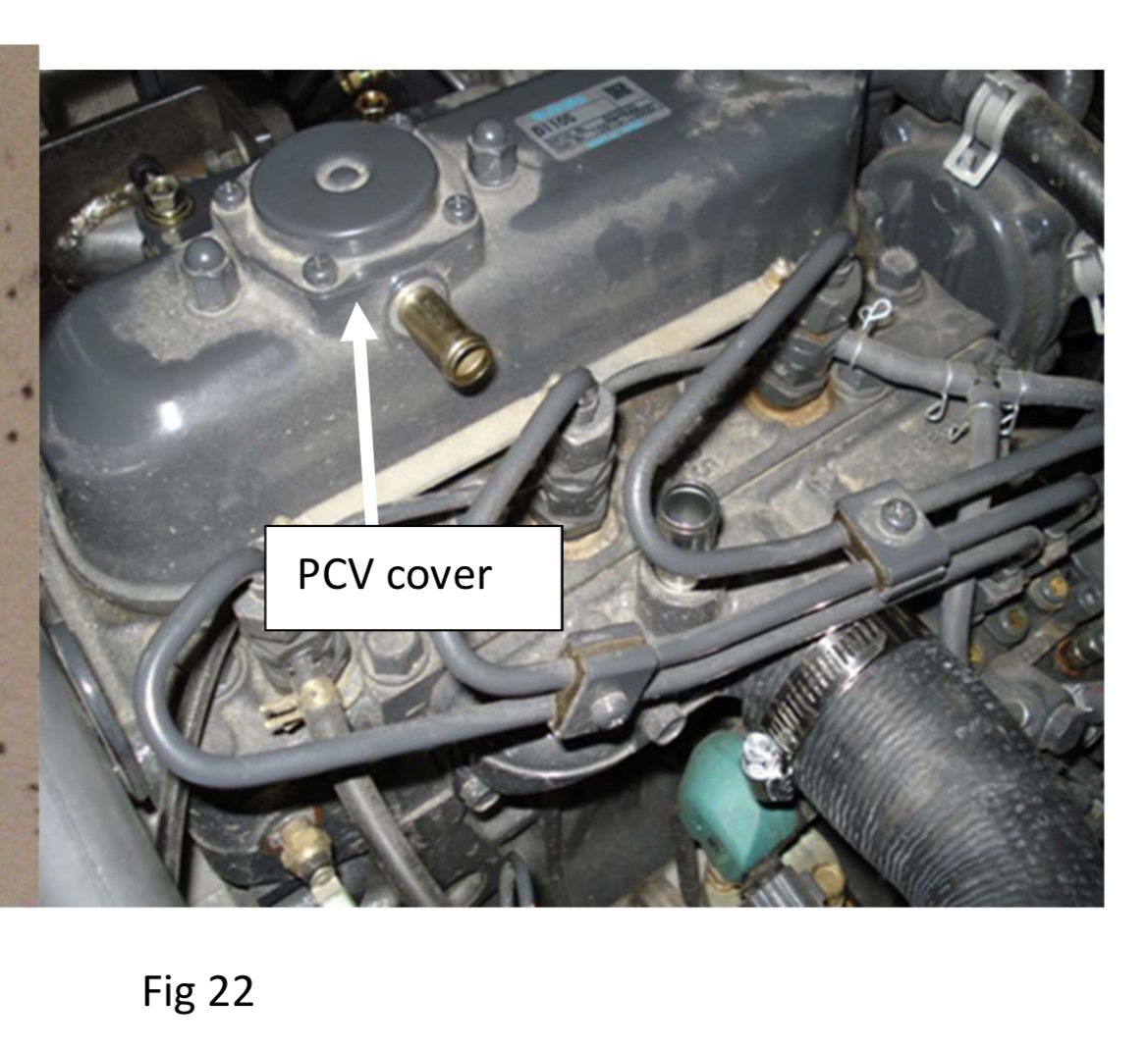

CCV/PCV
I ran across some info on another Kubota engine while doing some reading regarding the CCV/PCV and turbocharging. These particular folks were suggesting to remove a steel retainer and spring from the CCV/PCV and then vent to the intake.
Now, I’m not sure the D1703 has this assembly (I haven’t checked yet) but, I assume it does.
Assuming that the L2501 has the steel retainer and spring, I would imagine that as crankcase pressure builds, that retainer/spring opens and the gasses are released through the CCV/PCV hose and into the intake manifold (or inlet pipe w/ Turbo). On my Turbo System, I’m re-routing the CCV/PCV gasses to the Turbo inlet pipe. A re-route, which I have done, should be all that’s needed, correct?
Why would these folks suggest removing it? What’s the purpose?
Thinking out loud...
Do they simply want ALL excess crankcase gasses to flow through immediately? Or, do they believe the retainer/spring is an obstruction that is allowing more pressure than they wish?
I don't know.
Mike

I have heard that Kubota PCVs like to fail and blow out crank seals, then you lose all your oil and the engine seizes.
On mine the PCV hose just hangs down a little lower than the engine.
Hmmm, interesting. So, do you believe they are being proactive recommending the removal of the retainer/spring in the event of a circumstance as you describe?

For educational purposes, I’m still trying to figure out the CCV/PCV operation on this engine. If anyone has some insight, I’m game.

Mike,
Please don't do any kind of crankcase to intake feed on a diesel. Yes, it's nice for the environment to burn up your crankcase vapors. No, it's not safe on a mechanical diesel.
If your engine starts to malfunction - e.g. busted or bad leaking rings and gets blowby or fails otherwise (diesel in oil and surely other issues) having a crankcase feed to intake will and has caused runaway dieseling which will grenade your motor and tractor. The pcv thing feeds to a dump tube to atmosphere for a reason.
Thanks!

Mike,
Thanks!
Thank you for the explanation. Makes sense. However, the factory PCV/CCV setup is directing these gasses back into the intake manifold already. How is it any different with the Turbo system?
I just want to verify before making an modifications.
Mike

Diesel engines had the crank case vent go to the dirt for ever. I always route it to the ground.
