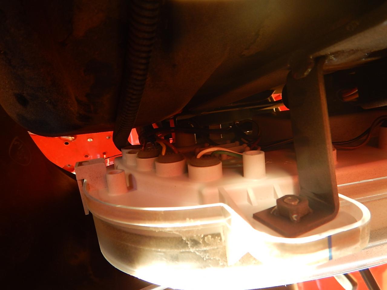

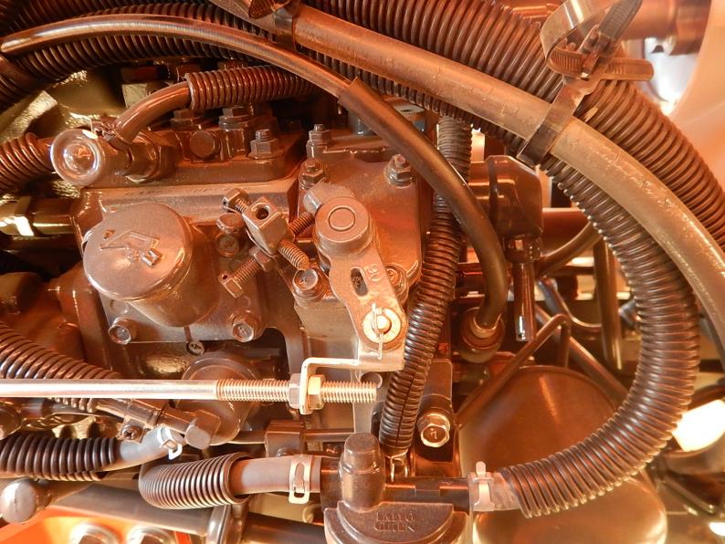

from Lugbolt "Could be either one. If it's on the engine and not loose, follow it up where it goes near the fuel tank and try to pull on it a little. If it pulls easily, it's come off of the back of the tach. Both ends of the cable are identical in that they just have a screwed on cap of sorts that holds the cable onto either the engine or the tach."
Okay, I think I located the tube that may hold the cable from the right angle drive at the front of the engine. Tube extends along right of the engine and then squeezes between the fuel tank to another right angle I believe behind the plastic cluster. Its 3 degrees this morning in the shed, so probably wait until it warms up to try to get the cluster loose enough to detach. The tube didn't pull free at either end, so maybe its the flex cable inside?
Anyone have a part number for a cable or cluster for the L2501? Thanks for the ideas and suggestions. May have to pull the steering wheel to get at it.

Front end of cable was easy to get off, the end behind the cluster will have to wait until the new cable TC420-34653 gets here. Dealer is sending it direct - 22.87. When I pulled the end out of the sending unit, only the spade end fell out. The rest of the spring cable is blind with the cable housing and will have to see if the tachometer is free, when I get the new cable. Thinking about prelubing with cable spray lube and a little squirt of oil on the right angle sending drive. Seems strange that the cable should twist off at less than 20 hours...

Beautiful warm day for a change, so I got a chance to pull the cowl off the cluster and unbolt the 4 - 10 mm head screws that hold the cluster in place. Didn't have to pull the steering wheel and with warm flexible fingers I could still get to the tach cable housing and unscrew the barrel nut from the right angle drive. Loosened the zip tie and snaked the cable out from the bundle and then could get the cable out and shake it. The spring wire core fell out - no problem. I guess if I could have shook the tractor on its side, the cable might have fell out on its own.. haha. Oh well, now its back together and waiting on the new core spring cable to slip into place ; square end first toward the dash, and then slip the spade end in to engage the tab on the front of the engine. The cable now has a nice smooth bow since it is free from the zip tie!!

Re: L2501 Tach Quit - new core cable installed
I remember reading somewhere not to use lube on the spring because it can cause other problems. The breakage is due to fatigue like when you bend a paper clip back and forth many times- it work hardens then breaks. Lube doesn’t help. Check the cable tube that there’s no binding or sharp corners due to an over tightened tie strap or something.
Cable came yesterday. Slid the new core into the cable from the engine end and tested with the cordless drill with slip clutch on setting 1. Had to reverse drill then WA LA tach started moving and speed drill up to 1000-1500 rpm and looked good with no hitchs or fluctuations. Slipped the slotted end of the cable onto the engine drive spade end and finger tightened the cable housing and all's good. Cable now has a longer bend since it's free from the tight zip tie, so hopefully its good for a long life

mine quit today with 164 hours. pulled cable off drive on front of injector pump and found drive cable broke 2 inches up inside cable housing. time for new cable. time to see if covered by warranty but i doubt it. will try to rout different it has pretty tight bend out of drive adapter back towards dash

Thats about where mine broke, Chevy. It was easy enough to just order the cable and put it in myself, although your dealer should warranty it for you.. I also removed a cable tie that lets the cable housing bow out a little more naturally, and hopefully lets it flex easier.
