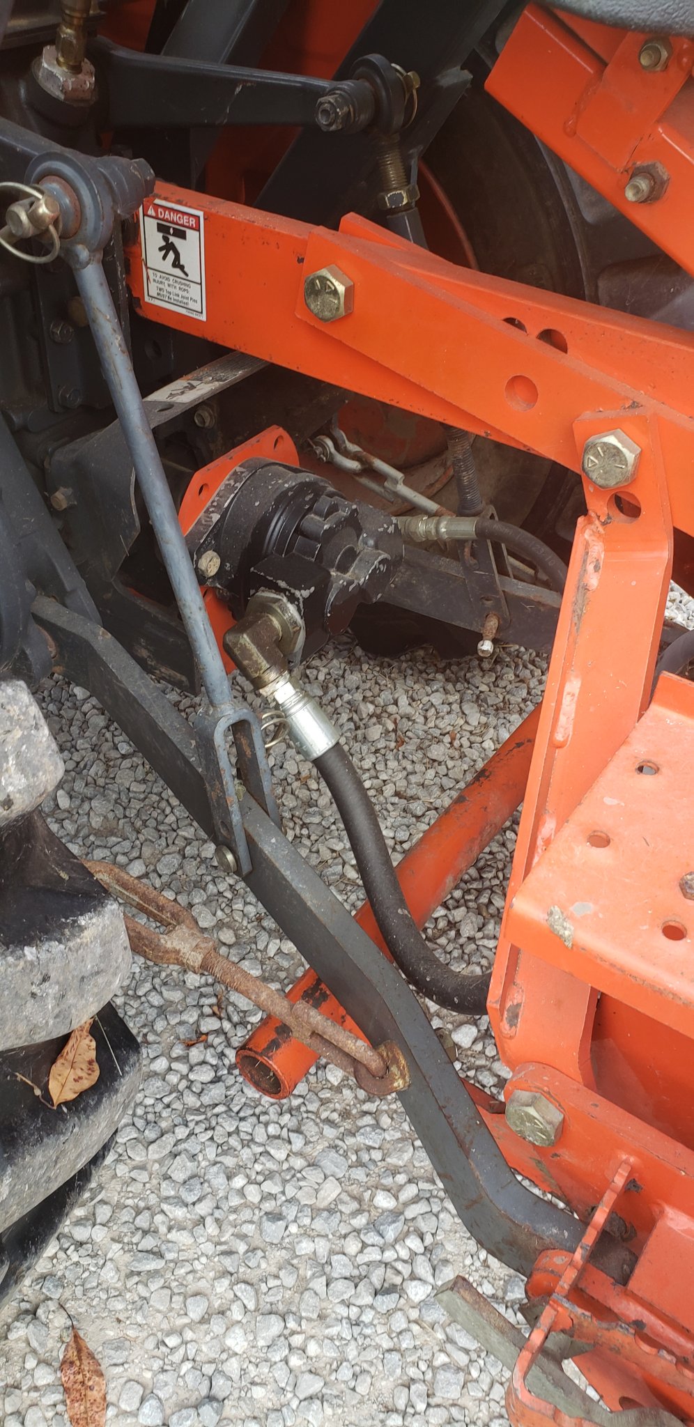

A PTO pump is easy and painless.
Just slide the pump on the shaft and connect to the plumbing on the BH and go to work.
It will be fast and efficient.

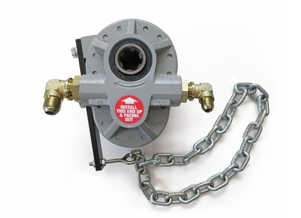

i was looking at this style pump if anyone had any pictures of how they made the mounting hardware,
pic for reference of oem pump and mounting, very different..
As long as you can fit it on the PTO its fine. But they are big and Kubota likes to obstruct that area with things like gaurds, drawbars, and sway brackets....
Measure twice, buy once.

That pump doesn't "mount" it just has an arm or chain that keeps it from spinning on the shaft.
This pic has the bar and chain attached, yes that's all it needs.

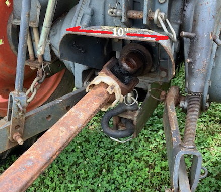

You need to measure but I think you would need a PTO shaft extension and some means to support the pump.
Shaft extention would make things easier. The depth of the 'guard' is about 8" and the area under the guard is roughly 10" x 10". However the guard is easily removed (just two bolts). Then there would be plenty of room in every direction for a pump.
There you go. Are you sure it will clear the drawbar and top link bracket?
