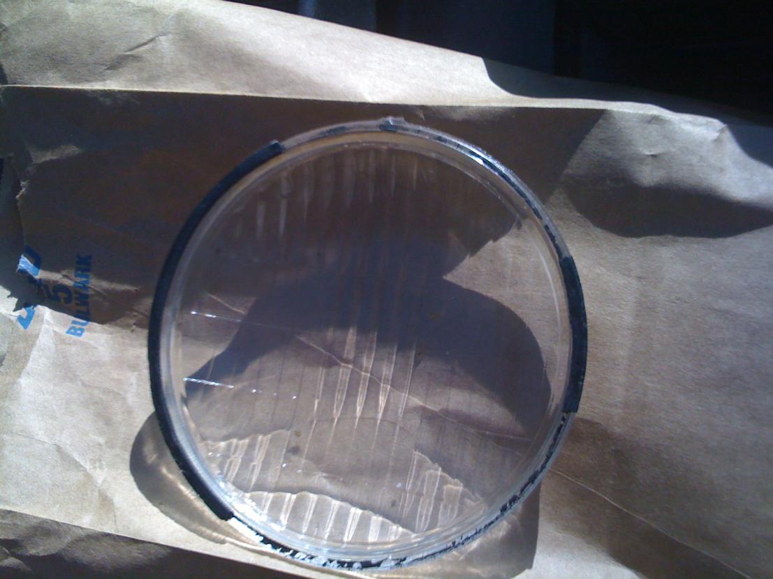

Ok figured this one out!
The glass lens is all that needs to come off. Mine was stuck to the reflector by the gasket and it took some prying to get it separated. Following is how it worked:
Take the light off the tractor (3 nuts with washers, disconnect wires)
Take the chrome ring off the light. There are 4 clips that are seen from the back. Push down on the side and the end of the clip comes out from under the chrome ring.
Separate the glass from the body. There is one tab on the glass that fits into the reflector body. Pry the glass there. Use a razor blade to cut around the glass to clear out dust and junk.
Push on the back of the connector to release the spring tension on the bulb holder. Rotate the bulb to unlock
Install the new bulb. The three slots align in only one place so make sure all three align. Push from the back, turn bulb to lock in place.
Reverse the remaining steps (put glass on, put chrome ring on, put 4 clips on, install back into tractor and connect leads.)
