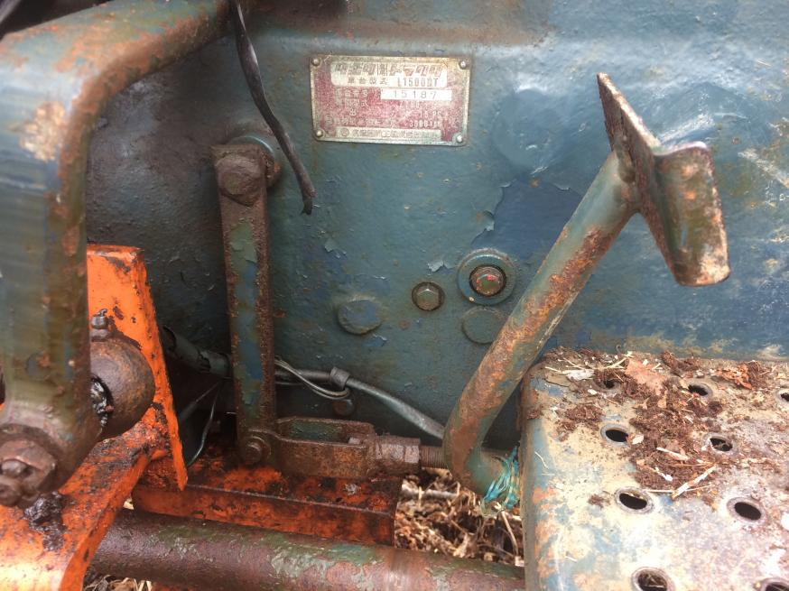

Today when I started the tractor, I was unable to put it into gear because of grinding. After inspecting the clutch pedal linkages and springs (checked out ok), I took off the clutch inspection plate, and sure enough it would not disengage when I pressed the clutch pedal.

What you are doing is what's usually the cure for a sticking clutch.
It often takes several attempts to free it.

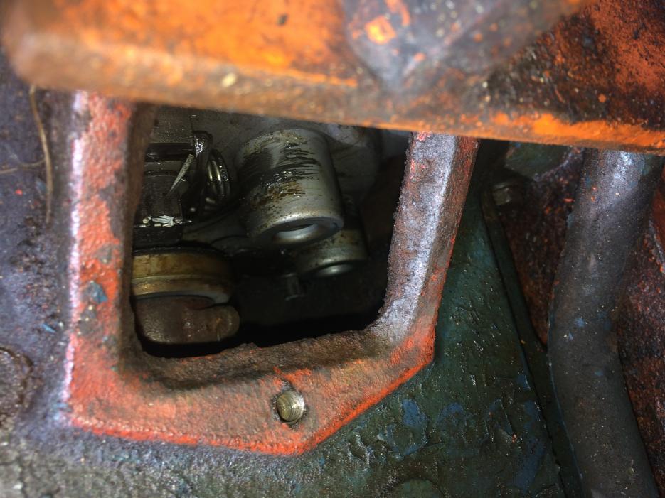

Not sure what I'm seeing in your second pick, but it appears to be oil or grease. This area should be clean and dry. It may have something to do with it being stuck, much like glue.
13,020
4,393
Your second picture indicates excess grease on the pressure plate.
Many tractor owners think the grease fitting on the side is to apply grease to the throw out bearing. Grease applied there does not get to the throw out bearing, it only greases the sleeve that holds the bearing. That grease prevents the sleeve from sticking on the shaft, and was on the older tractors since they were designed for rice patty work and often got wet. There was also a drain plug at the bottom of the bell housing to let water out!
You'll probably have to spit it to clean it up (and determine if something has failed) or it will keep doing the same thing.

What about hitting the inspection opening with an aerosol brake cleaner, while also having the bell housing drain plug open? This could potentially clean up some of the excess grease.
Would you advise against what this guy does?

I wouldn't do it, you could do more damage than good.
If the clutch housing was not sealed after repair and has gotten moisture in it you'll need to split it, manually clean the rust and corrosion off of all parts, and reassemble it and seal the clutch housing.
Post some pictures if you do split it to make sure your on the right track.
