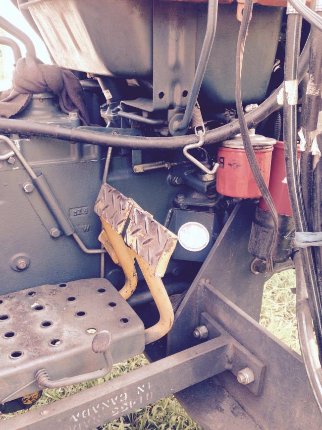

There's a small plate held by 2 bolts by your right foot when seated.
Throw out bearing is behind it.
Mine has a white plug (recently installed)
