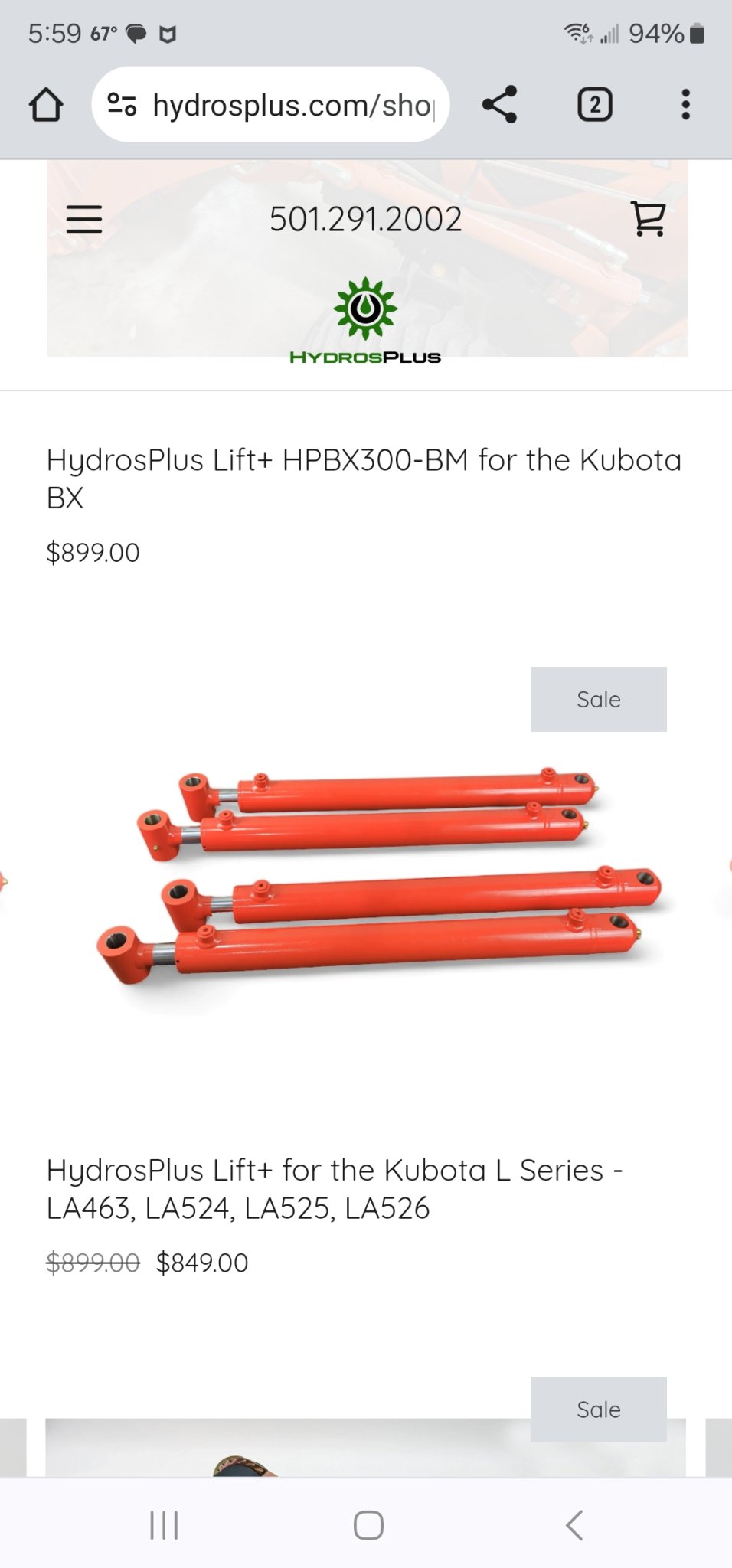

I bought my L3800 new in the spring of 2013 just before the smog crap was added. That helped push me into buying sooner. But one thing that's always bugged me is the 1000 lb max lift capacity.
I happened to run across a video and the link the larger hydrolic cylinders to add 30% lift capacity. I think my loader list a capacity of 1200 lbs. It's never done that. When I have steel delivered they know it has to be a max of 999 lbs if my order is over that they band it in two packs to unload separately. I'll be ordering a set soon.

I have considered replacing mine with a tad larger cylinders as well. I would think you could just spec out a tad larger diameter with same stroke and buy them for half this price... Maybe just move up to a 2" bore?

~$1,600 to replace all 4 hydraulic cylinders seems excessive and like my pressure increase, the weak link will be hoses bursting and loads slamming to the ground. Plan a head for that as a possible thing to happen.

Plenty of videos on Youtube that show the increase in lift with the new cylinders...
