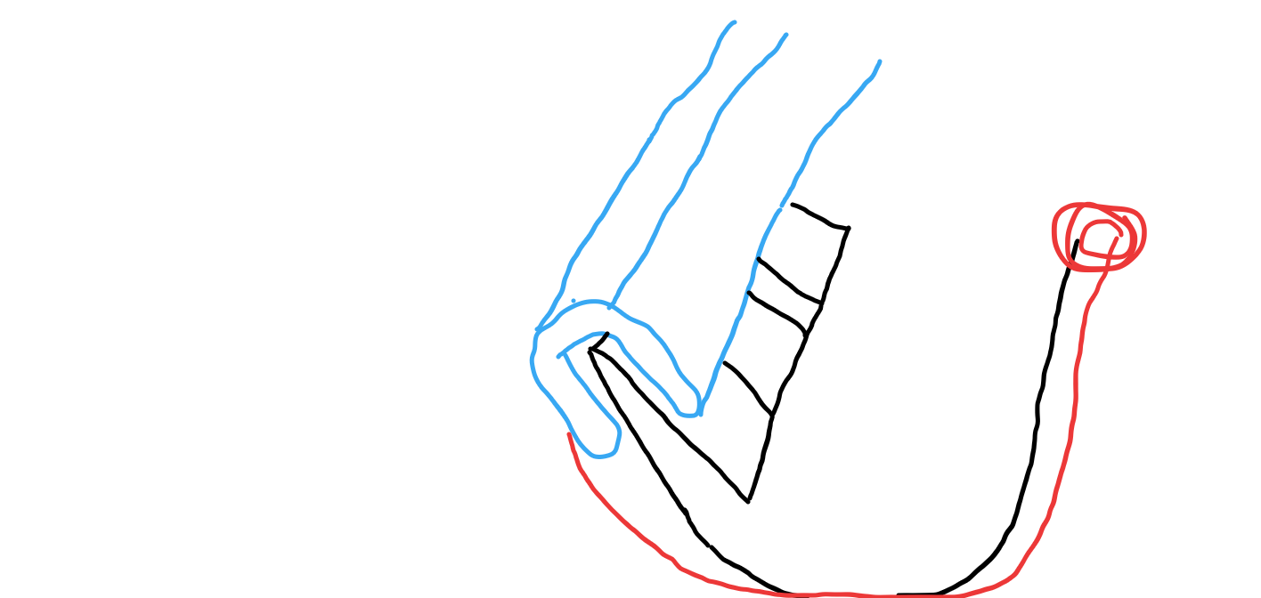

Off the top of my head, I would think that a properly sized piece of U channel could be laid across the teeth of the bucket to provide a flat surface to "pinch" with. Sort of like a Landscape bucket...
Securing it might be as simple as press fitting it with the bucket then knocking it off with a hammer when done.
Or possibly weld a piece of chain on the U channel and wrap that around the backside of the bucket to secure it?
Please excuse the crappy drawing LOL
