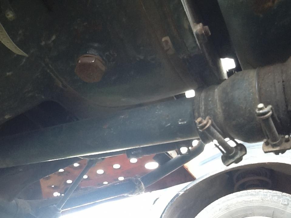

My guess would be that the drain plug you removed was not actually the drain plug..... therefore no oil drained, and the new 5l just overfilled it. Can you get pics of the drain plug you used?

That plug is for the bellhousing, which holds no oil; it is only there to drain water if the tractor has been run through deep water.
The plug you want should be about 12-14 inches forward of that, in the engine oil pan, which should be directly above the differential. (the big bulge in the middle of the front axle) I'm not familiar with your model, but it should be similar to my B7100. The plug on mine cannot be seen looking sideways under the tractor, it must be viewed from directly below..... it is left of center, just behind the front axle. Once found, I now locate, remove, & re-install it by feel.
Try hunting for it with lots of light & a mirror..... mine is so low, it's hard to get your head under there to see it. And don't lose the gasket on the plug.

Okay, oops! Was not the right drain plug. Found the right one and out came my oil.... Black :(
