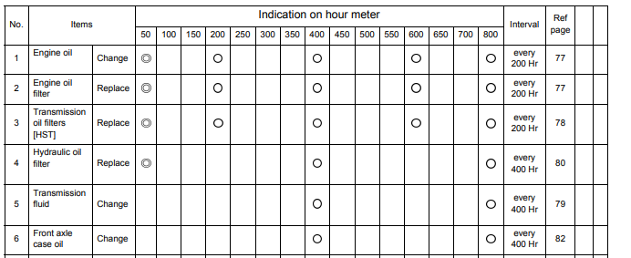

Ok so I am a little confused here and maybe you guys can help clear it up. If you look at the maintenance schedule that I uploaded for the MX series, Kubota is showing that the transmission oil should be changed every 400 hours. However, they are also showing that the transmission oil filter should be changed every 200 hours. So are they saying to change the filter independent of the fluid?
That is what my L3901H manual calls for also. Filter at 200 and fluid at 400.

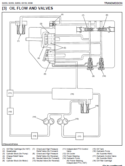

Ok, So I'm following you and whitetiger now. The "suction filter" is the Hydraulic oil filter. So that would mean there are two different pumps and hydraulic systems on the tractor. One for transmission and the other one for auxiliary hydraulics such as loader and rear remote valves?

Here's a hydraulics block diagram from a B2050_B2350_B2650_B3150 WSM. It appears that the oil gets filtered by the sump suction filter right before the 2 hydraulic pumps, then again at the just ahead of the HST.
One hydraulic Pump (for Power Steering, Independent PTO, HST).
One pump for 3-point hitch.
Thanks for the diagram upload Nbryan. Ok so I was almost on the money with what I was thinking but which pump supplies oil to the auxiliary hydraulics?
Orangeman... if you look at that mx schedule again.... and look over further to the right side of the page, under the “Interval” column..... you will have your question clarified. (Yes, change the filter at 200 hrs and the fluid at 400 hrs Repetitively.
