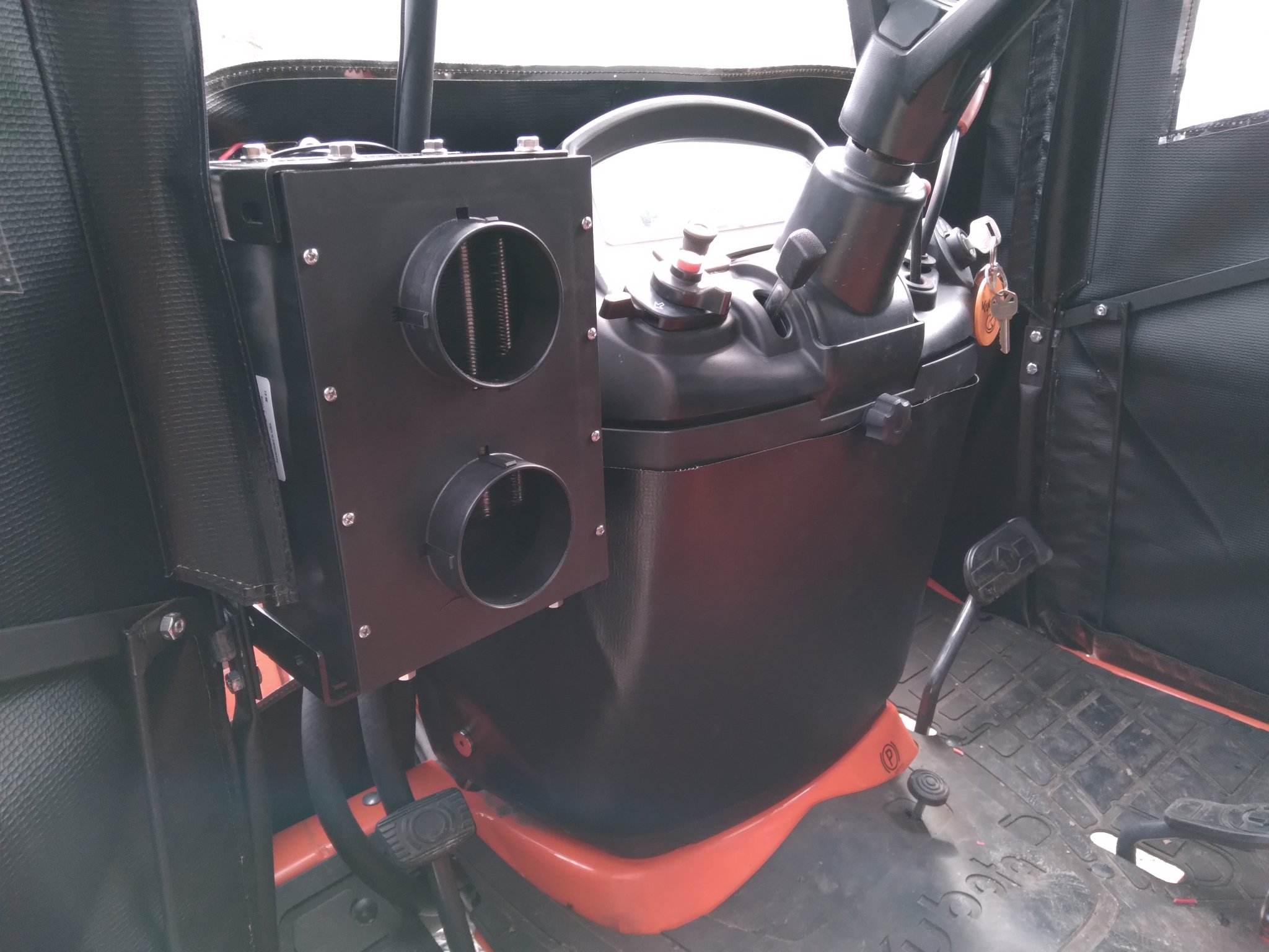

Leaveraddict, how is the Jeggs heater working for you? does it warm up the cab enough? I am thinking of getting one.

I've had a Jegs heater plumbed into my home made B2650 cab now for a number of years. On the coldest winter days with outside temps well below 0°F the heater can have the cab close to +90°F inside if you'd want. Mine is inserted in place of the water pumps bypass hose.
Using winterfront covers also helps to keep the engine coolant temps up in the normal range for supplying hot coolant to the heater core.

The Jeggs heater is working great! I keep the screen under the steering wheel blocked off so the heat doesnt get sucked right out and it also keeps cold outside air from being pulled into the cab! As bird dogger suggests keeping the engine warm helps keep cab temps up!

Great, thanks for the info, I think i'll get one. Right now I use a golf cart propane heater that has worked very well, I can clear snow in a long sleeve sweat shirt, I did make a cover for the screen and blocked open holes under the seat ect.... The reason I didn't plumb anything in yet was because I thought it would void the warrantee, but my salesman says it does not :)

Hi Leveraddict, I was wondering if I could get a pic of your Jegs heater setup? I want to get a feel of the size and an idea of where I will place it.
