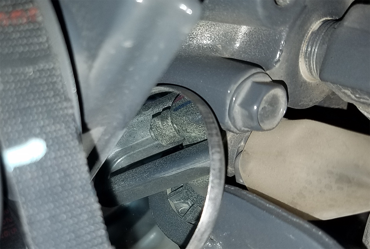

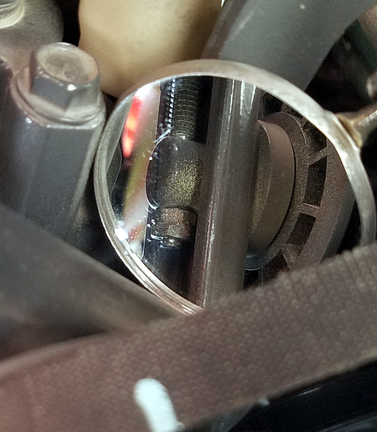

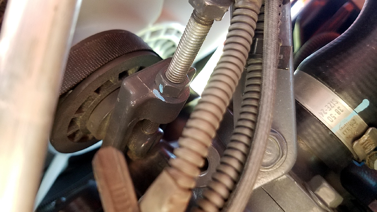

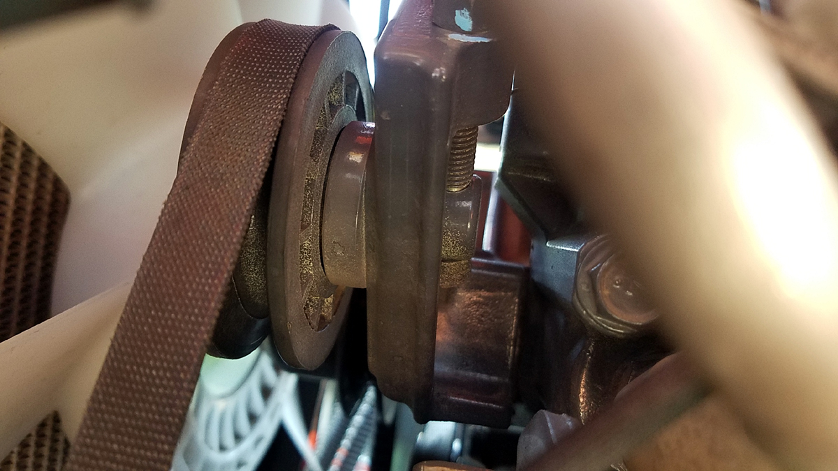

I tried to get a better view of the nuts underneath the idler this morning. I have an automotive mirror and should have used that yesterday but maybe these images will help someone else now that you have it sorted. It does look like two nuts that are jammed together.
