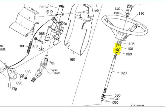

Could you plse look over these exploded parts illustrations from Messicks.com On the most relevant parts diagram and add an arrow showing the direction and location of the movement you are noticing.
I think that we are all puzzled a bit by your problem and this approach may bring more comments.
Dave

The M5140HD has a different column then the M5140HDC
There are 2 bushings in this column, there does not appear to be any grease, i do believe they are dry bushings.
M5140HD column:
13,093
4,462
If you have excess play moving the shaft up and down the problem has to be in the lower end. The U-joint or connections must be loose. The bushings on top will not effect the up and down play, only lateral play.
M5140HD column:
Yes, thats the bushing in the yellow highlite. The movement back and forth movement the steering wheel shaft move forward and back towards the seat also would move side to side. I imagine the clearance between the bushing is a bit more than it should be tractor has 680 hrs on it seems this is way to soon for this kind of movement. It has no place to lube the bushing that I can see. Not bad enough to trouble with replacing the bushing yet. Again seems way to soon for this annoyance. Thanks Sorry I had so much trouble explaining the movement
