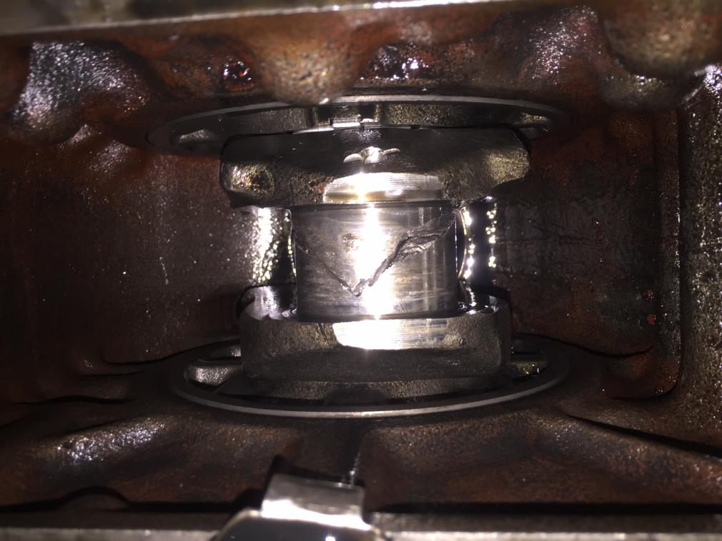

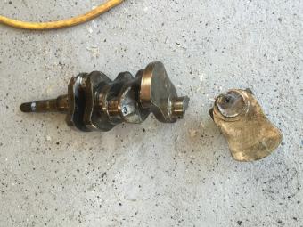

I got a Kubota L245 in a partial trade for some repair work that I did on another tractor. The guy was doing some box blading and it just started smoking and died. When he went to start it he heard a knock as the motor turned over. I pulled the engine and the crank is broken in the middle of the rear rod journal. There doesn't appear to be any other damage, even the connecting rod is still in good shape. I don't know if I want to put the money into another crank unless I can source one cheap. Does anybody know what all engines will fit the L245? The DH1101 seems to be a tough engine to find used. I'm not above doing to modifications to make it work.

Can you post a picture of the break? Sure seems there would be other damage.

He was using his box blade is all I know. I guess he hit something. I tore the engine down and everything is in good shape. All the main bearings and the other two rod bearings were in good shape. The break was in a V shape and the rod bearing kept everything in place. When I turned over it just had knock like a spun bearing.

The "V" shape is typical of a torsional break. If it was on one of the mains I would look for a failed or missing vibration dampener. Still could occur on the rod journal. Thinking more along the line of failing injector of miss-timed pump causing high cylinder pressure. This is a typical failure on gas engines when spark plug wires are swapped for long periods.
I would look for source of failure before I spent too much repairing. Hate to see it happen twice! Jeff
