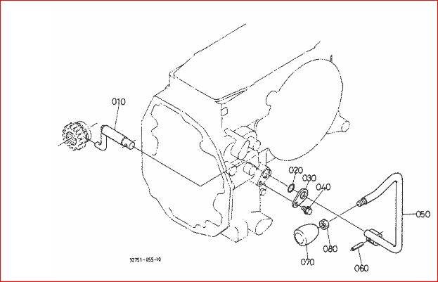

It's not that great of a mystery why it won't shift into 4wd, it either has a broken gear/ grove or bent/broken shift fork, either one it's going to take splitting it to fix it.
The 4wd shift fork on this is not what I would call Kubota's better design, it's a simple bent rod instead of a full fork, it only engages the gear at one point instead of 2 like a normal shift fork.
Pulling the top of the 3 point lift off should let you see it, but that's it you'll see it, you will still need to split it to fix it, so save the time and effort of pulling parts that don't need pulled and split it at picture #2 and get it fixed.

With your camera can you look to see if the rod (item #10 in second picture) somehow got pulled out of the groove in the gear? If so, maybe you can get it back into the correct position without separating tractor.
