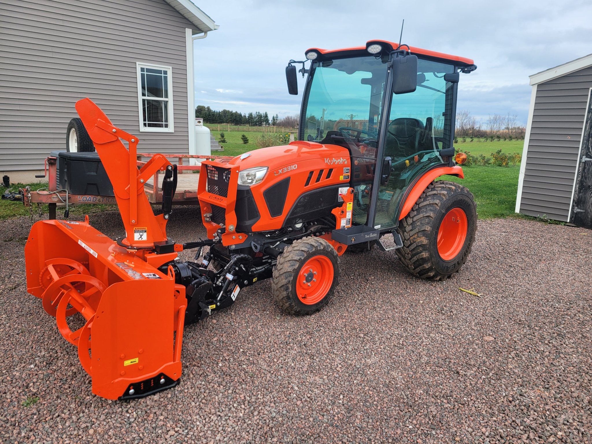

I picked up my LX 2980 in a crate, assembled and installed myself. The blower is made in Canada. the driveline crate had a big label “MADE IN CHINA”. Hope mine lasts 🤔😐.
My driveline crate said made in Canada. It came into the dealers in June or July they just dropped it off this afternoon.
