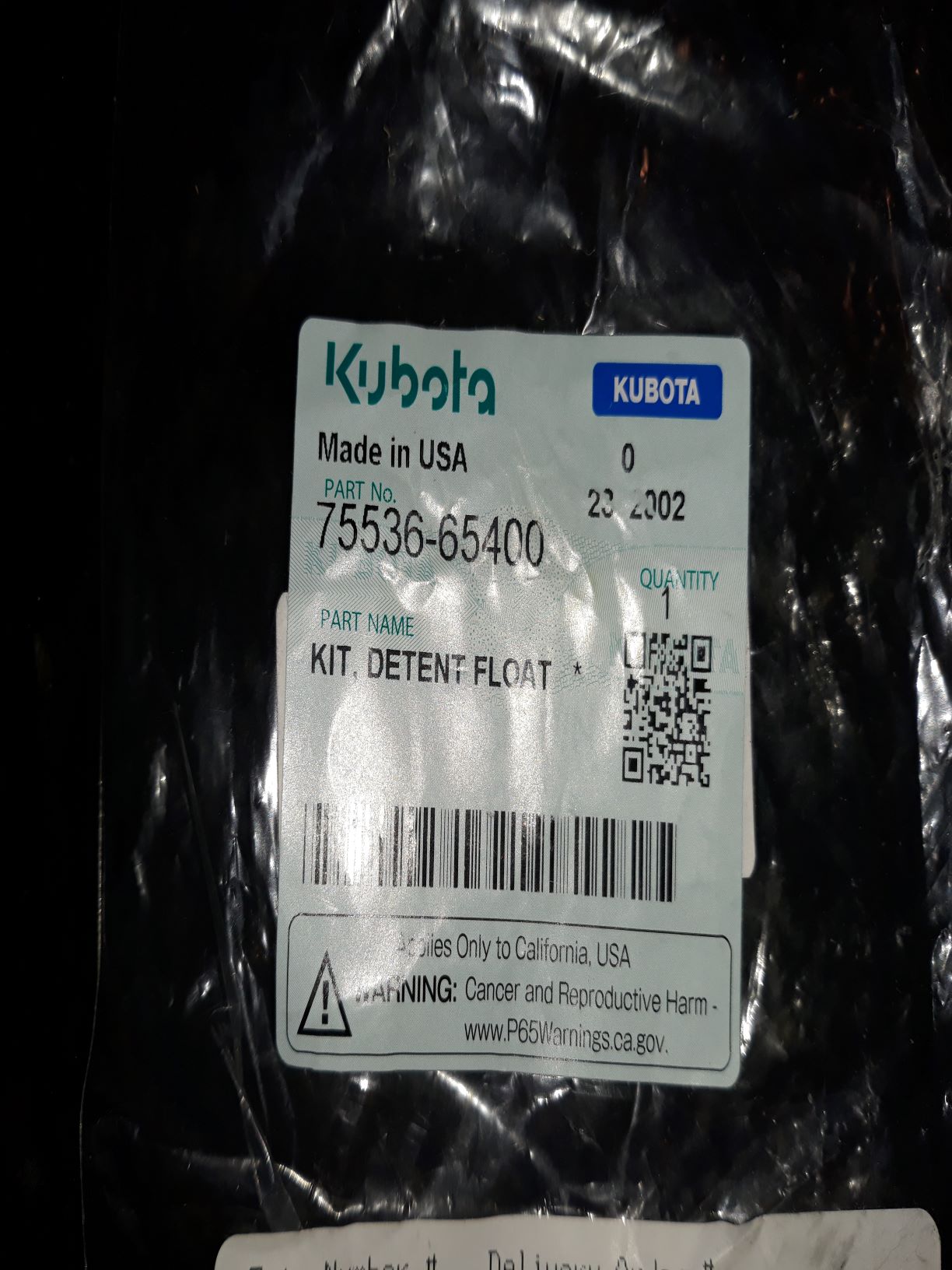

Ok, my turn at resurrecting this thread, which is great by the way!
…Why?
As the ‘22 Winter progressed the float detent was getting harder and harder to engage. During one snowfall and a good “smack up” on the stick, the next thing - no more detent. No more float…though, if I held the stick in the up position - the blade would float. On a 275’ driveway that gets old quick!
So I got the detent kit listed…and before I dig in I have questions:
1.) The two cups that are above and below the main spring in the diagram, in the kit one looks to be cheap galvanized pressed metal and the other a more heavy duty thick steel.
I haven’t gotten to take the existing valve body apart yet so I cannot compare, so I can only assume that the heavy duty one is toward the cup end? And the galvanized one is up closer to the valve body?
2.) The fella’ on youtube that took the idea from a fella’ here about drilling the outer casings so water has a way out and WD-40 a way in…due to the bad sealing. Has anyone used a silicone or other sealant to make these parts a bit more water tight? Good or bad idea?
Thanks!
Kutch
Kutch
BX2200, BX537A, BX2763A
Dec 21, 2022
10
NY
Well, it’s finally done. Put the new Detent kit in and it works perfectly. The youtube vid made doing this easy!! Thanks!
