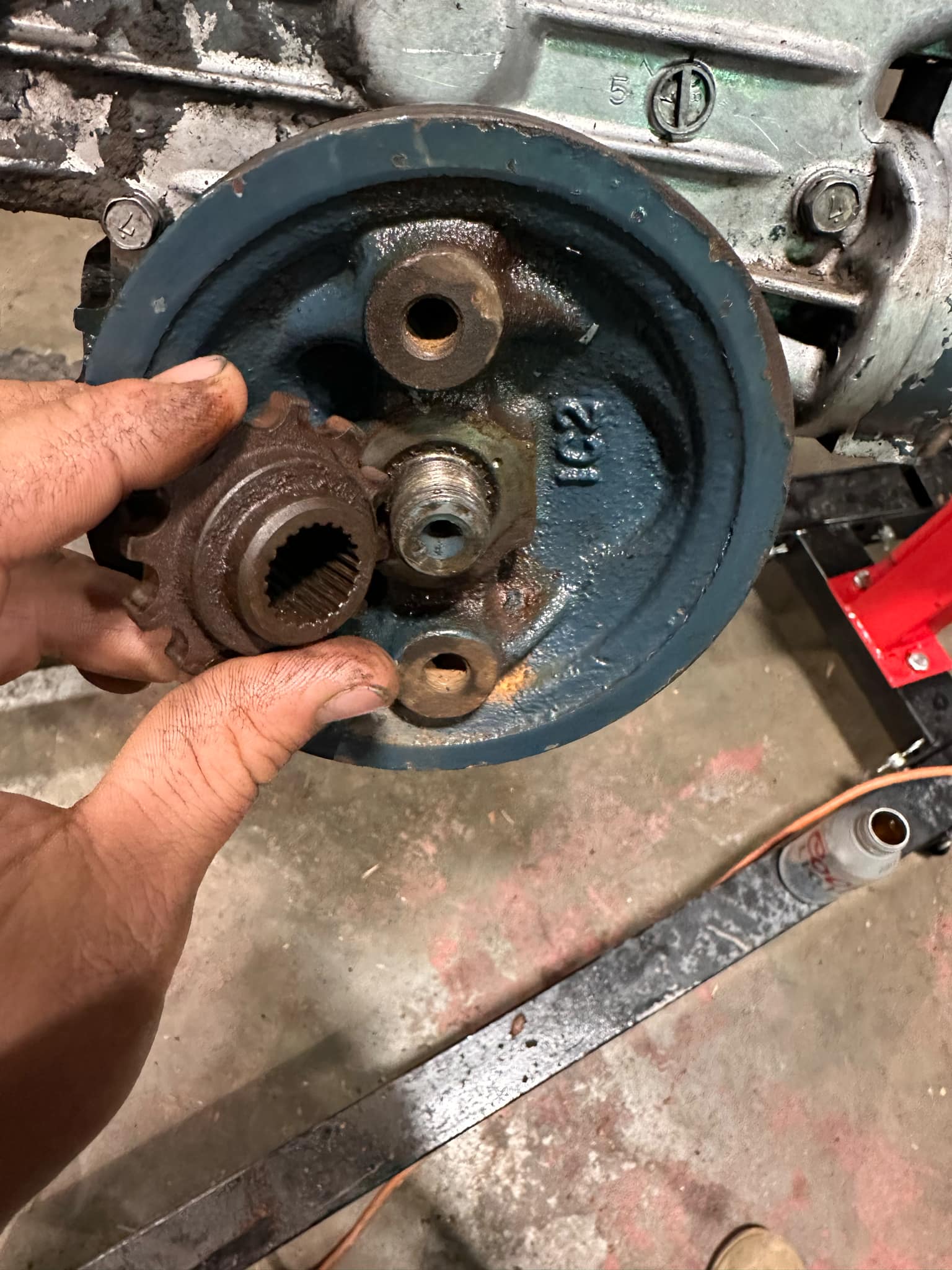

Good morning. I don't have a part number but looking for the adapter to bolt onto the crankshaft pulley of a d850/d950 to give it a splined shaft to use a hydraulic pump. By chance anyone out there have one laying around?

Pretty easy to make your own takeoff and it gives you much more flexibility in the size and type of coupler needed.

Yes sir. This one is for a customer that put a d950 in a b7100 and still wants to use the front pump on his b219 loader. I was just trying to help him find one. But its probably gonna be easier to make one

Easier in multiple ways. The spline on the OEM adapter is a PITA to match.
