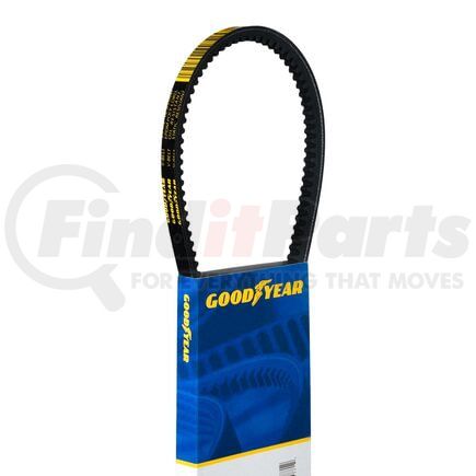

I searched your original belt number and Messick's has a picture showing the manufacturer's part number, Mitsubishu REMF-6415.
Apparently Goodyear's 17425 cogged belt interchanges with REMF-6415.
