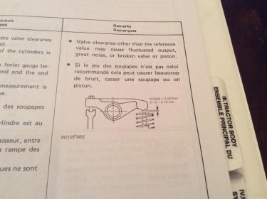

So I checked the valve lash and I'm glad you mentioned I should because this is what I found. Working from the radiator towards the gas tank the valves were at .014, .010, .009, .007. The manual says to gap them between .0059 - .0074, so I gapped them all to .006. I fired the tractor back up and there was unfortunately still some white smoke. I checked the decompression valve and it was definitely off or closed. I removed the cap on the valve cover and noticed that there was some white smoke coming out. I could only see the smoke when I angled my light just right. With the naked eye and normal light you can't see it. Not sure how much smoke indicates blow by. I am planing on doing a compression test tomorrow and I'll be honest I'm not looking forward to it. Haha

I grabbed the dimensions from the workshop manual, I attached the photo of the page. But the top end is .0005 off of .008 so I can change them. A little extra practice. Lol
A greater clearance would yield a longer compression time, which would lessen the chance for unburnt the fuel to enter the exhaust?
