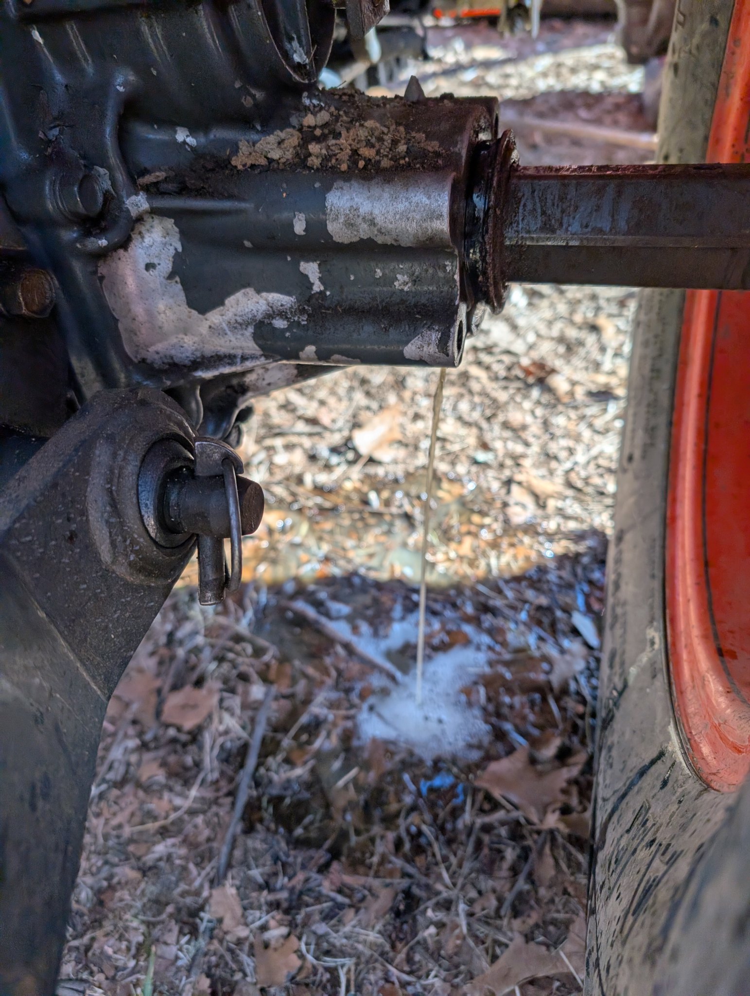

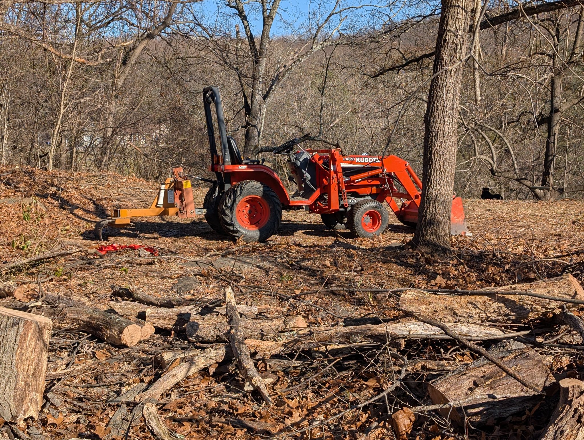

In my recent post, I indicated that I had a number of small leaks which I "dreamed" of fixing. I received a lot of helpful responses. Today, I was clearing a downed tree and moving a large piece when my b2400 HSD, serial no. 72874, bucket got sluggish. I dropped the tree and went about 20 feet and the tractor slowed when moving forward - jittery. Turned off the tractor and looked under and saw a leak from the right rear axle - see pic. It appears that the right rear axle is out about 1/2 inch more than the left rear axle. My tractor is now sitting in the field behind the house. see pic. The flow of oil was fast but it took me some

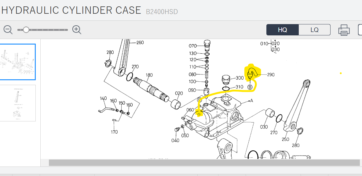

Lift the seat and confirm that the vent is open and working.

a. I think the "seal" is what extents out about "1/2 inch more than the left rear axle" as shown in the pic. This is the area where I apply the sleeve retainer?

2. you say "confirm that the vent is open and working." I can stick a wire down the vent hole to ensure its "open" but otherwise do not know how to ensure it is "working"?

Just bend it and look at the vent, they typically get mud dabbers that build nest in them.
push it in, and use a soft hammer or a block of wood and hammer to knock it back in seating it to the edge lip of the seal, red arrows.
Sleeve retainer will go on where green is after you clean that surface with brake parts cleaner.
