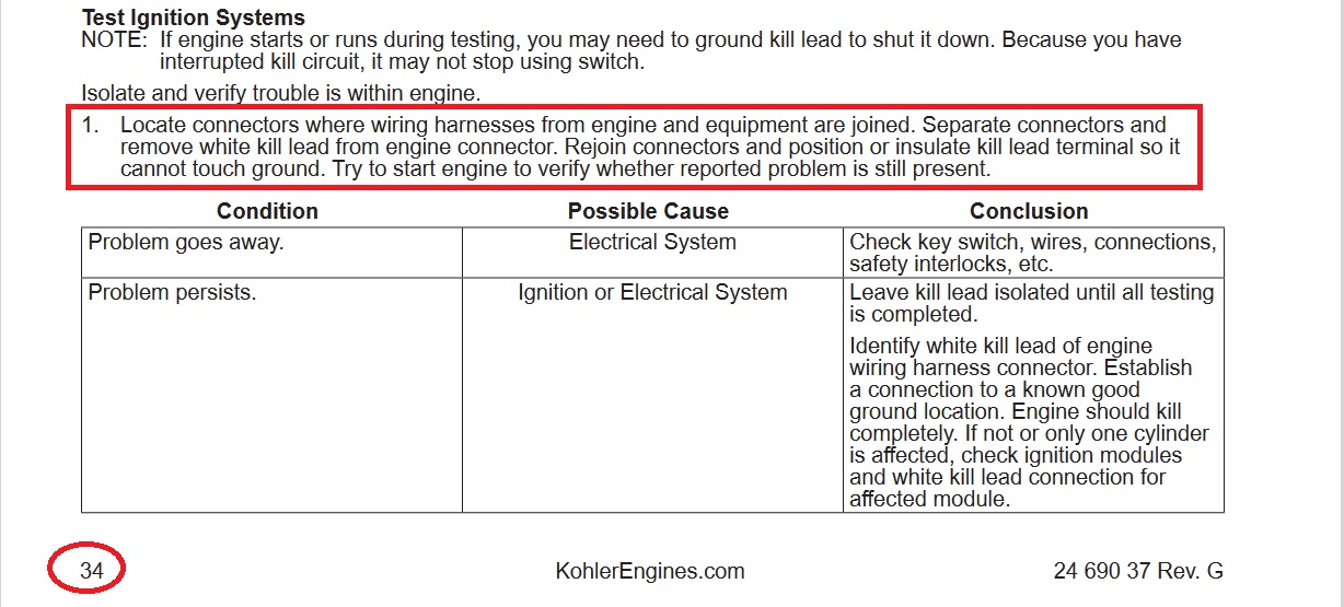

Hea guys, I own an automotive shop we do not normally work on lawnmowers. I had a customer ask me to look at his Kubota Zero Turn K725 Kh with Kohler CV742-3011. The dealership would not touch this. He came in with a wiring issue. Here is what we found there was no spark, and the diode was bad and some bad relay, and the COD box was also. The other rectifier was bad and the starter was stuck in the start position. We purchased the cod box and some relays. Kuboat did not show a part number for the Diode so we `used a GM diode that fit in a small fuse holder.. After all this testing of continuity and making sure it all checks we tried to start no such luck . So I hot-wired it and found we had no spark at the plugs. so we test the sensors on the motor. We found the oil switch it also the kill switch so we replaced that It still will not start at the key but will turn over when jumping it. we have plenty of sparks but the motor will not run. We have replaced the start switch and tested it it works. I fit to be tied at trying to get the **** thing running. Any help would be greatly appreciated
I have a Toro with a Kohler Engine. I always find Kohler's web site is very useful when it comes to no start situations.
Kohler CV742 service manual
Kohler recommends you break the connector which ties the engine to the equipment. In that connector is a white wire which is the 'KILL" wire for the engine. You remove the white wire from the connector and replug it together. Now try and start the equipment.
If the engine starts you now know the problem is with the equipment and not the engine.
Of course now you cannot stop the engine without shorting the white wire which was on the engine side of the connector.
From page 34 in the WSM for your engine:

We tried this and does not work. Thanks. We hot wire it and the motor will turn over and have a spark. It will not fire even when adding starting fluid. The key will not turn the motor over either. I going to try the fuel solenoid on this carb to see if that works. Still confused with all the stuff we tested and replaced at the factory parts.
If you followed Kohler's instructions and their motor does not work, this means in their world you have determined the problem lies with the motor so stop checking anything on the machine.
Did you download and read the Kohler WSM that I provided the link for?
What happened when you removed the white wire from the connector and reconnected it? You said "does not work," but this could mean many things to forum members trying to help you.
The engine WSM is important as it will have a step by step diagnosis process which saves a lot of time and needless parts changing.
Dave
I have the Service manual on my desk it's in a binder after I printed it, The white wire is the kill wire that runs through the oil pressure switch or sensor. If this sensor is bad I will cause no spark issues the sensor is normally closed during the startup operation. We ohm checked it and it was fluctuating from 0 ohms to 20 ohms. So we replace it with new factory one. As for the timing, I did try to move the flywheel and did check the end play. But it was still factory-tight the rust around the shaft and bolt did not show any new metal scars. So all this told me that the key was still in place.
