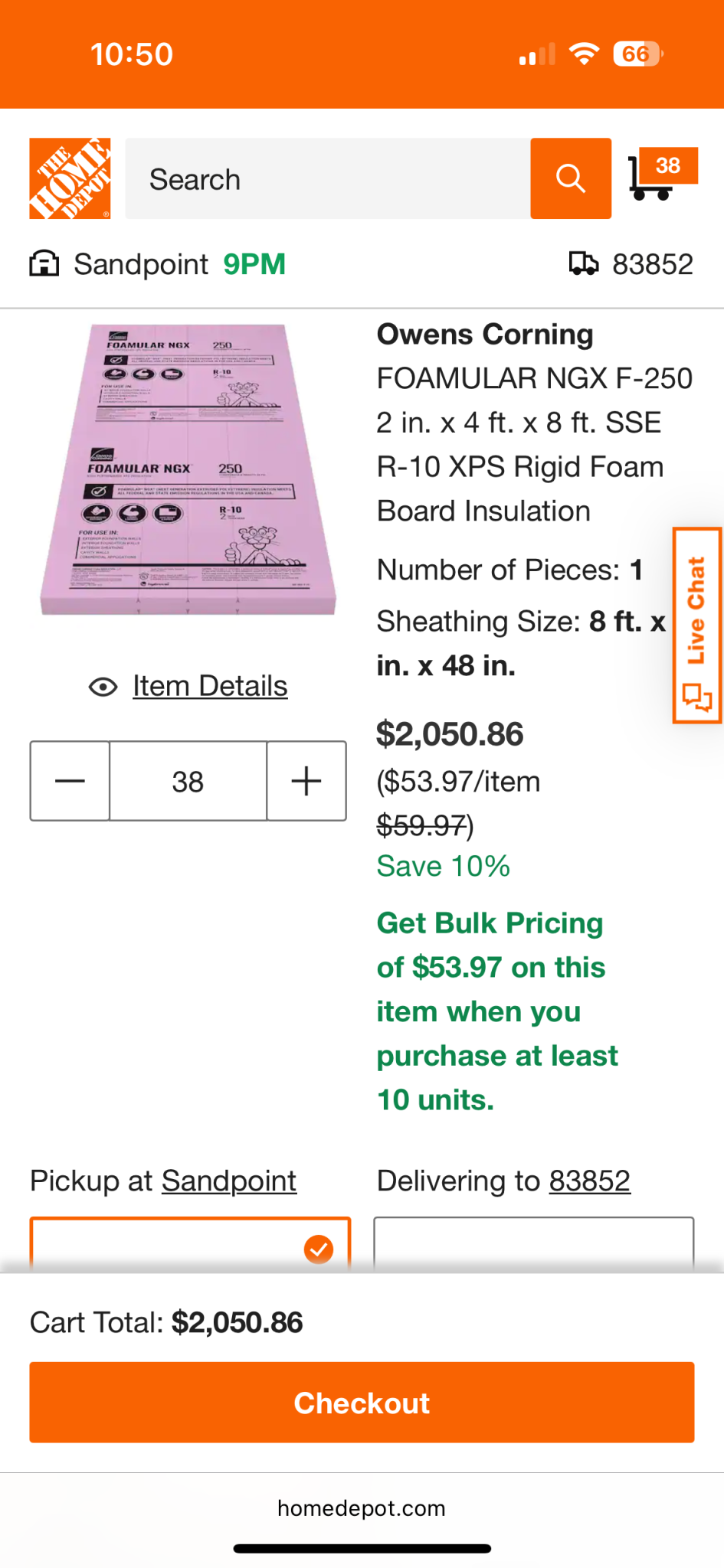

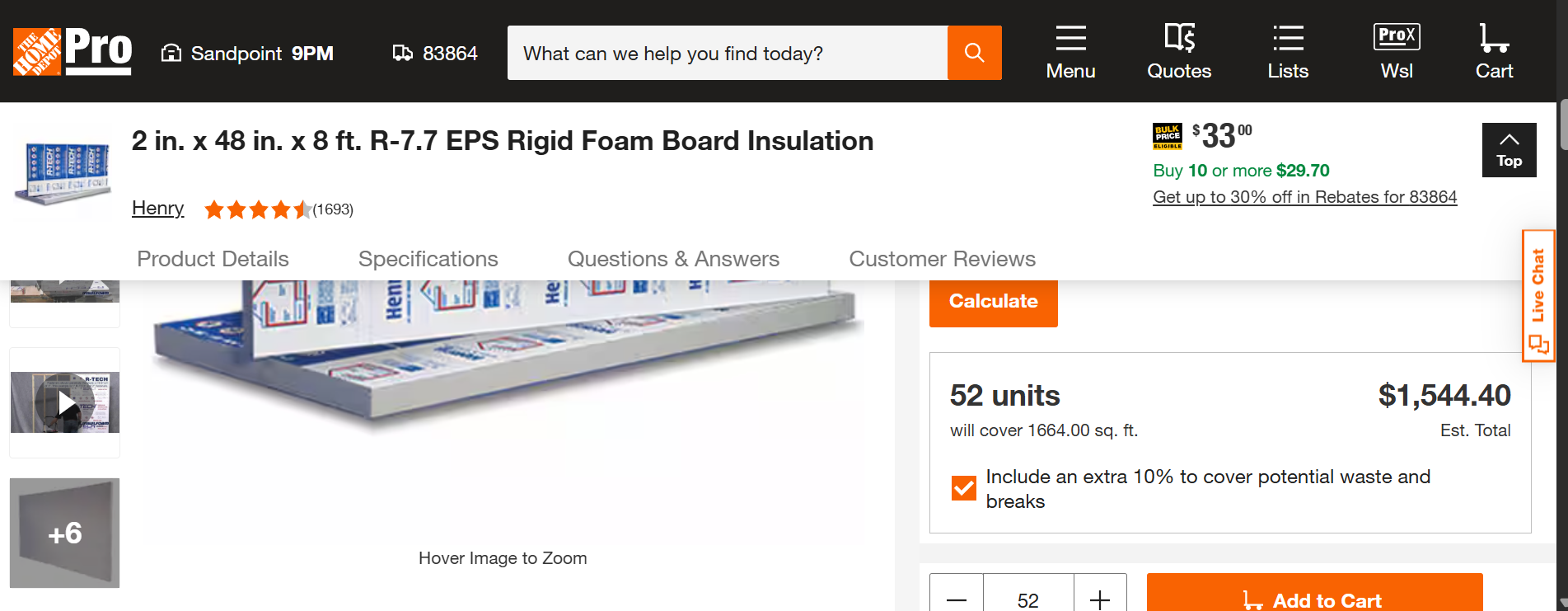

Where are you getting foam for $1475?? I’m seeing closer to $6 grand for 1500 sf

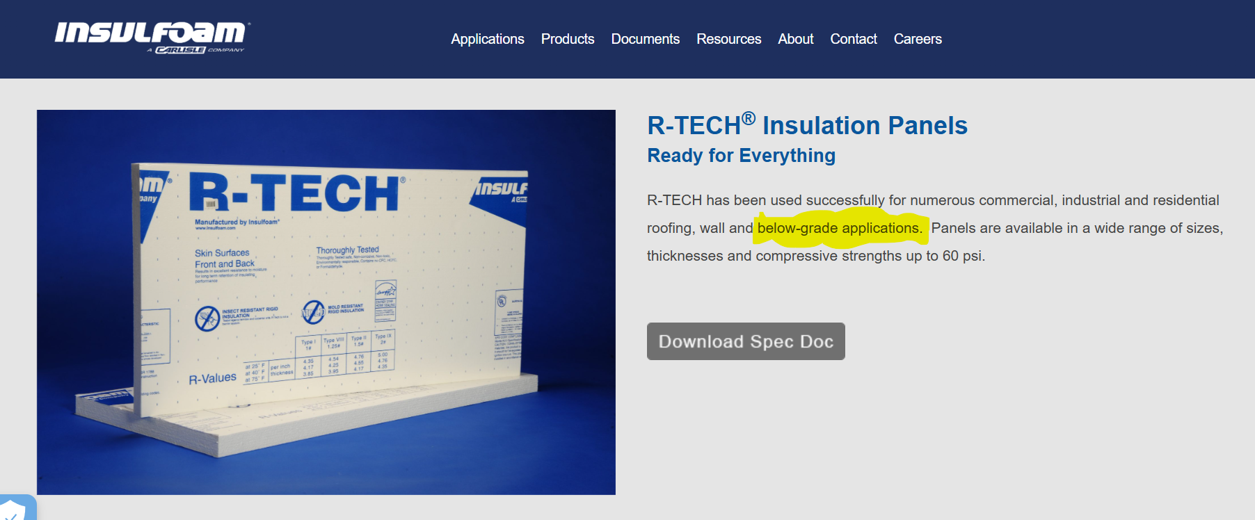

HD, 2" R-tech $1,544.40
This is closed cell foam, so it's good for below grade, where other "white foams" are open cell and are not suitable below grade because they absorb water.

Hi density Foam specifically for under slab at Home Depot. I also found this which is supposedly good for under slab:

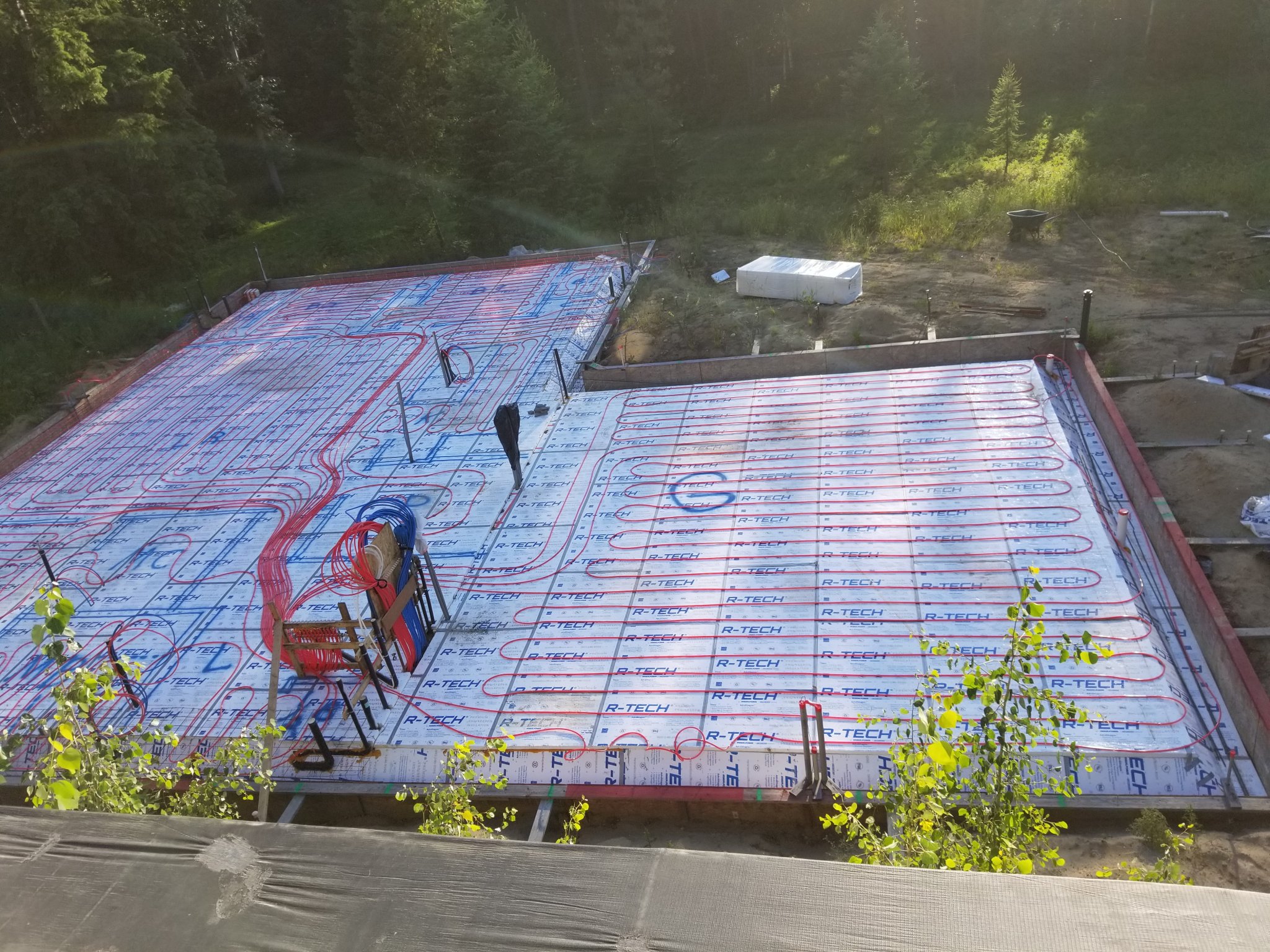

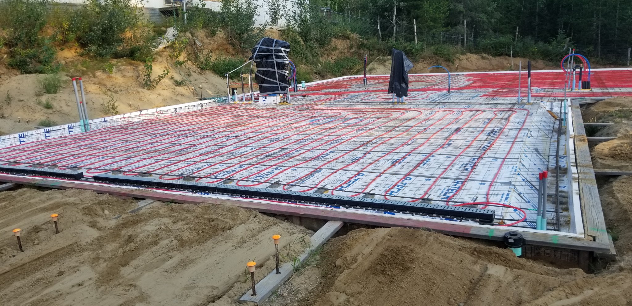

The above pics are of our foundation on our house and garage.
R-tech was used everywhere.
House is 2800SF, Garage is 1050SF
House is winter and summer 64-68 degrees depending on room, garage is 60 degrees.
We only heat with Propane and hydronic heat and my bill last year was $1200 for all heat and domestic hot water, so a very efficient house.
We have all my domestic water lines under the foam and we never have warm water in a cold line, so I'm not getting heat transfer into the ground under the slab.
I tested this foam from summer of 2013 till 2019 and got no water absorption or degrading, I got no loss in R valve, and it does not compress when used under slab.
I have several homes and buildings that have used this foam and everyone of them has the same results.
I did do my due diligence and have a proven track record with using it.
I have also used the pink and blue foam in the past and got the same results for way more money!
If spending $500 more make you happy go for it.
If you want to borrow my foam staple gun for the pex just let me know.
