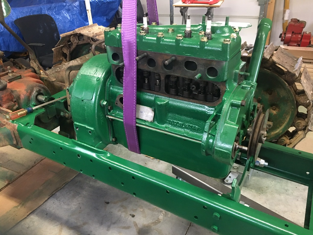

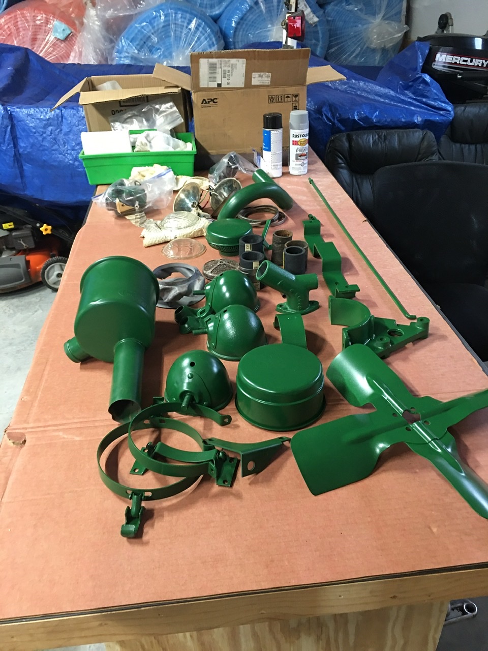

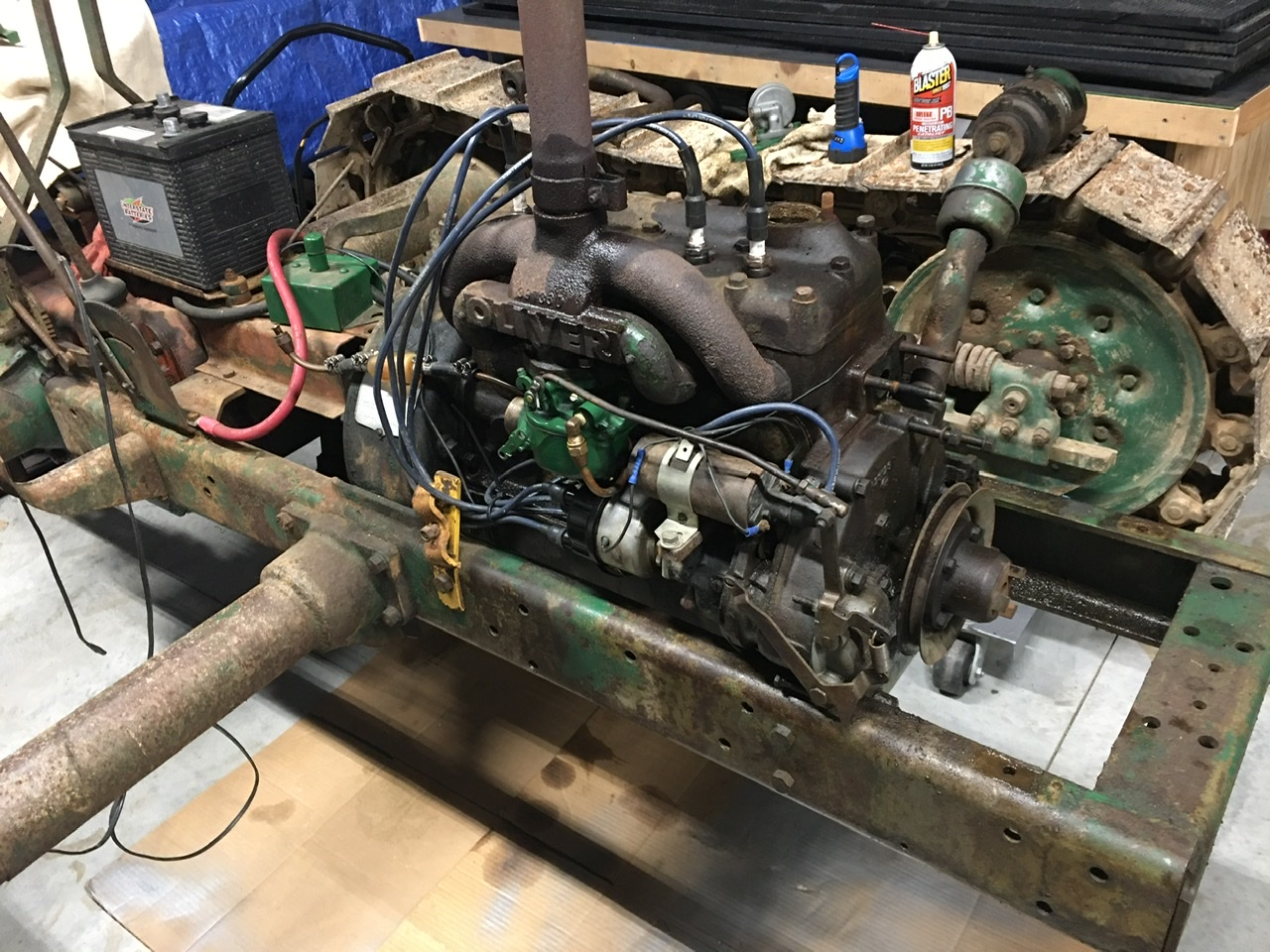

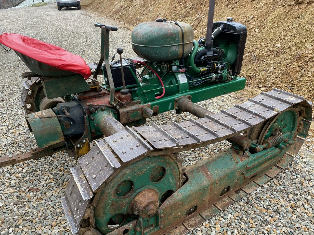

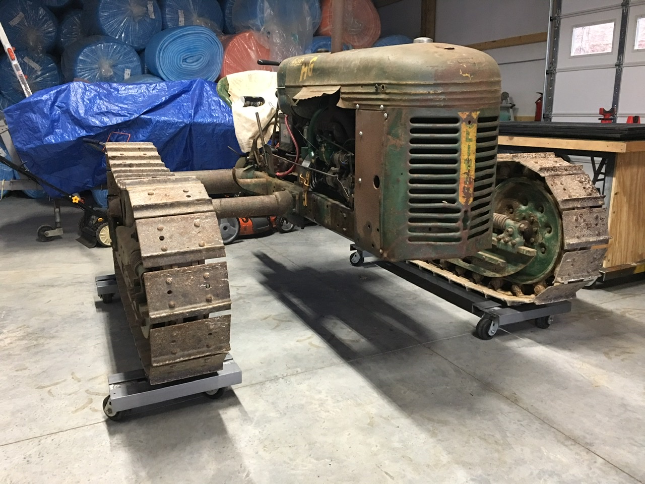

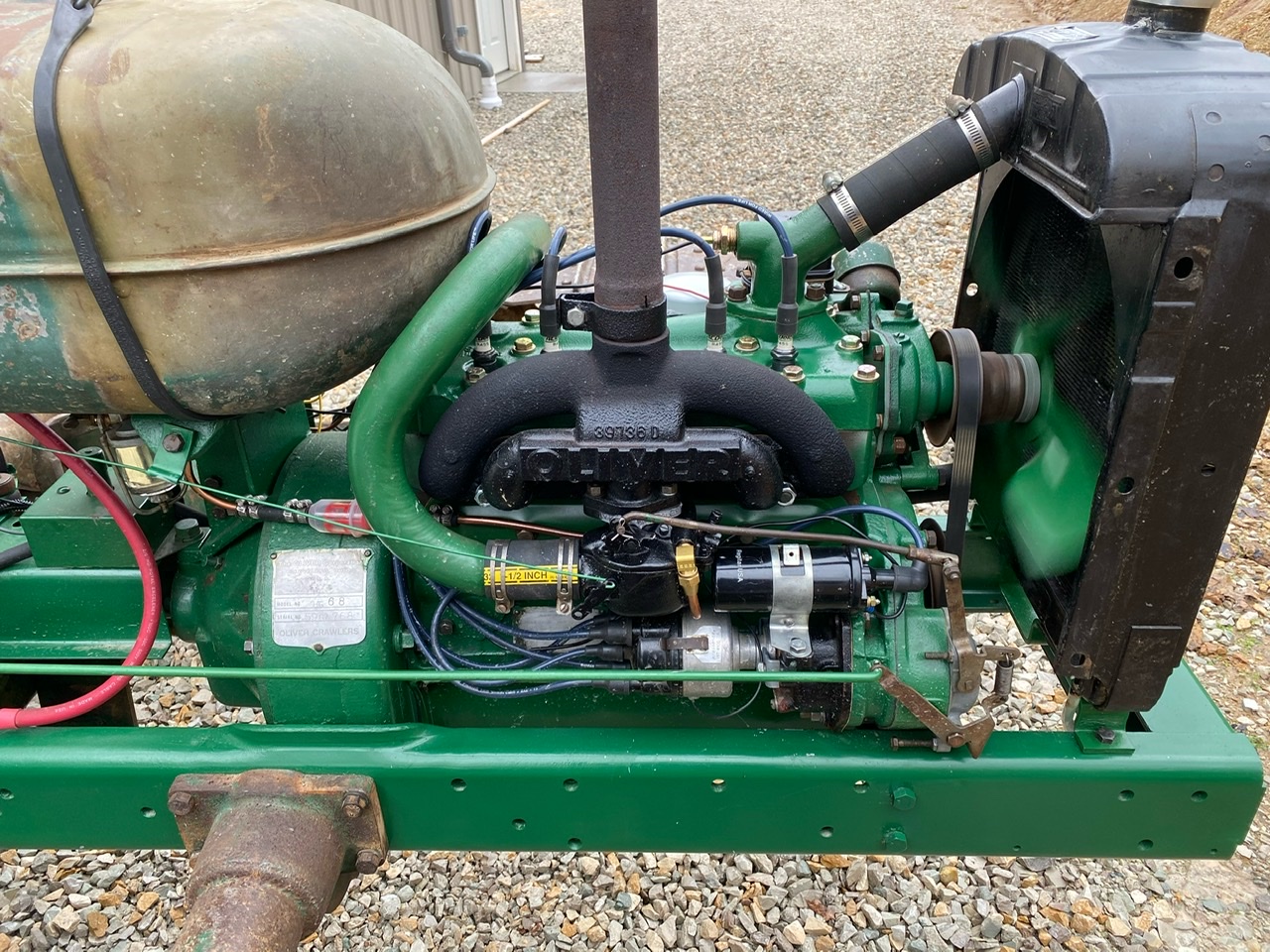

It’s my 1951 Oliver Crawler HG-68. My family bought this brand new in 51. I am in the process of restoring it to first class working order. Not show quality. I have rebuilt the motor. Years ago I converted it to a distributor system. I have just converted from 6V positive ground to 12V negative ground. Got it started on last Friday. It’s doing great! It will have an easy life now. At 70yrs old it will pull logs for firewood, pull a drawbar mower and a lot of sunday afternoon tractor rides!
If my pictures work the first one is before I started. The rest are during the rebuild process.

Thanks guys! Dad let me start driving it when I was 10. By the time I was 12 I was plowing the garden and bush hogging by myself. It has a 4 cylinder Hercules motor. Anderson made an after market 3 point hitch for it. It was braced off of the transmission case and we continually broke bolts. I’m not putting that back on but I am installing the hydraulics. I have a tank and pump that goes behind the grill. The valve is attached to the right front side panel. I anm going to add a cylinder to my draw bar mower to raise and lower it. UpNorthMi posted pictures of a farm dump trailer that operates off of the tractor hydraulics. That would be sweet on the hilly property that I own!

Way to cool! Nice work. I like your roller stands for moving it about in your workshop!

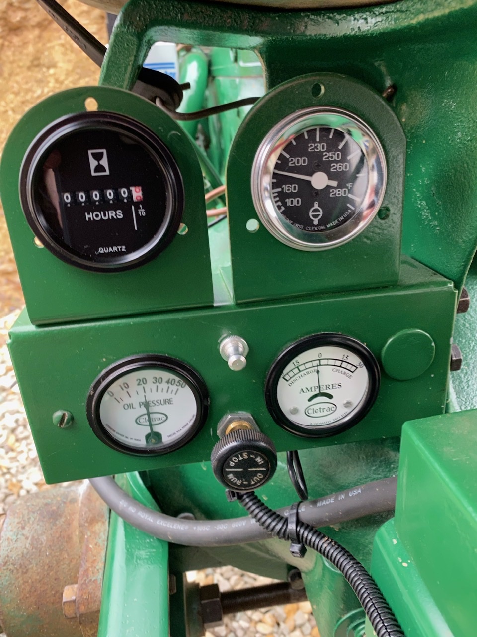

GoeHorn those are some nice show tractors! I would be afraid to go into the woods and pull a log with those! I am restoring mine to what I call first class working order. Mine was 6 volt positive ground. You can’t jump it. A winch would be very expensive and you are limited to what lighting you can use. I converted it to 12V negative ground. I have the original lights and I have restored them but I am putting LED bulbs in them. I took the 6 V generator to a local electric shop and they are converting it to 12 V I will put a 12 V regulator on it and that part will be finished. The next thing I am going to do is take the power take off off and flush the transmission put new sterring bands and seals and close it back up and put fresh gear oil in it. When the weather breaks I will do more painting. My buddy is going to help me with body work on the hood and side panels. The track rollers, tracks and final drives are very good shape and just need cleaning and some tlc.
I am having a blast doing this! And I am going to have a very usable tractor! There is a company that specializes in olivers. Zimmermans Oliver & Cletrac in Ephrata PA. Has everything you need to rebuild one of these.

wow that is a great piece of machinery .. looks like you got the 12 volt conversion done really nicely

I got the 12V conversion done. I had the original 6V generator rebuilt and converted to 12V then I replaced the voltage regulator with a matched 12V one. I have the original hydraulics for it. I am rebuilding that now. I am going to put rear remotes on it. A friend picked up the body panels to rehab and paint. When I get those back I will post more pictures. He has a CNC plasma cutter. We are going to build a custom grill guard for it.

No I don’t have a blade. Oliver endorsed a couple aftermarket companies that made blades and buckets and 3 point hitch attachments. I have an Anderson 3 point hitch attachment for it but the design is not to good and it stressed the transmission case.
My great uncle bought the tractor new in 1951 interestingly I have a letter, envelope and all sent to him in 1951 thanking him for visiting there booth at the KY state fair and enclosed is a brochure for a new Oliver Cletrac with a Ware blade. Dad said my great uncle always wanted a blade for it.
