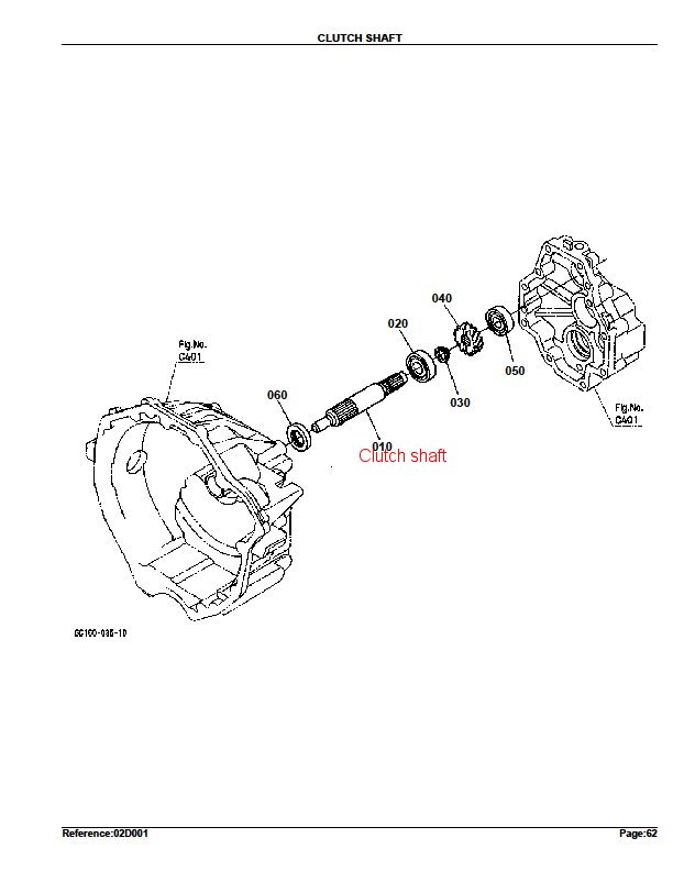

As you could see these two images, from Clutch shaft to Propeller shaft.
It look a like transfering power from the engine to transmission.
But, Why is it keep on turning even clutch is disengaged~???
and dealer said it is normal~?!
That Propeller shaft is the one could be stopped by hand after clutch is depress down.:cool:

Hi Joe. I figured that was what you meant. The shaft on my B72oo did that but you should be able to stop it real easy. If you hold the clutch in for 5 seconds can you put the tractor into gear without any grinding. And can you shift the pto in gear with no grinding. If you can then you have no problem. Your tractor is a standard transmission pushing the clutch in and trying to put in gear in 2 seconds may not work. Some one on here once said that with a standard transmission patience is a virtue. If it still grinds after 5 seconds then you may have to adjust the clutch. When you adjust the clutch you want the pedal to push just alittle bit farther it may not take much of an adjustment :D dusty

It would be better if the input shaft stopped alright but there really isn't much to stop it when your tractor is in neutral. If the clutch disc is at all draggy on the splines it will be enough to keep it turning a bent or heat damaged disc would also cause it. But if it is that easy to stop my guess is that it's the nature of the beast!. Some transmissions have a brake to prevent this, If you wanted to make one for yours it wouldn't hurt anything. could be as simple as a strap around the shaft that pulls tight when you push the clutch pedal.

Your B7510dt doesn't have a live independent clutch. It doesn't have a live or independant pto either. all you will find in there is one clutch disc. It could be warped or sticking on the splines causing it to turn but I doubt it. I believe it is the nature of the beast because you can easily stop it with your hand. If the disc was warped or sticking it would not be easy to stop. Remember, there is not much turning in the transmission when it is in neutral and the pto is not engaged. It takes very little contact in the clutch to keep it turning. Expensive tractors and trucks have a transmission brake for exactly this purpose! Kubota didn't think it was necessary. You could build yourself a little transmission brake or just shift the transmission with the engine at idle and put up with the grind like all the other B7500 owners do.
