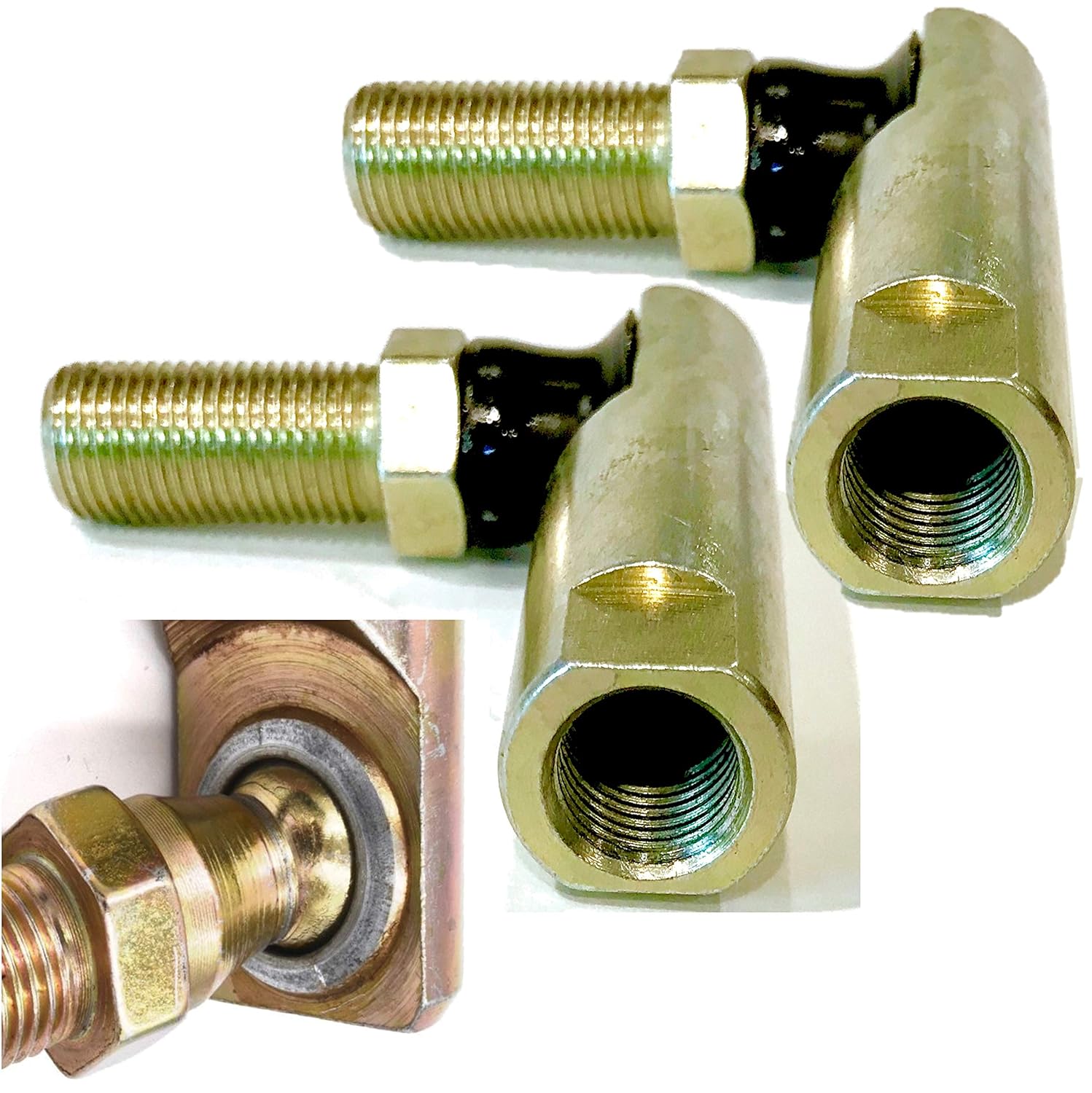

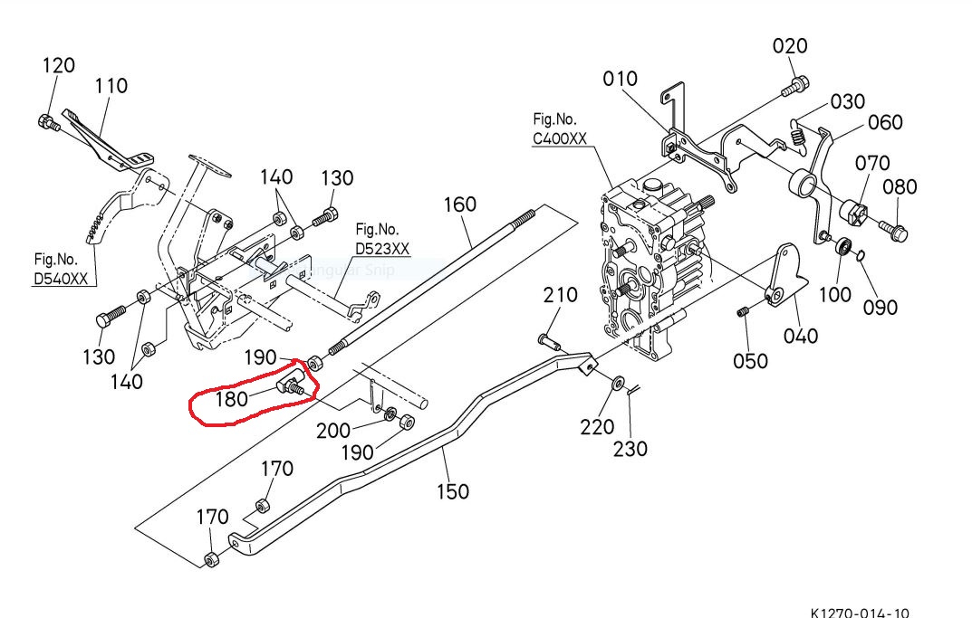

I stumbled across this while looking for the reason the hydro stat stopped responding while mowing. the unit is a GR2120 with ~ 500 hours on it. Has been well maintained and garage kept.
After locating the "somewhat hidden" neutral valve and towing it to my shop. The ball joint on the pedal linkage had just fell apart. Ii was quite surprised at that it was 5/16-24 thread.
Thought i would post this in the hope that it may help someone else.
Thought i would post this in the hope that it may help someone else. View attachment 152446
i've had to replace more of those than I care to even think about. It's just part of owning a GR series mower, IMO. For what they cost, they are junk (IMO).
They are called a heim joint when you go to look them up.
