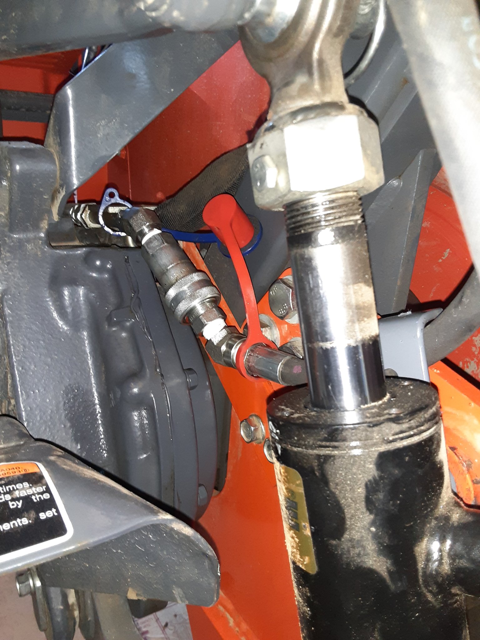

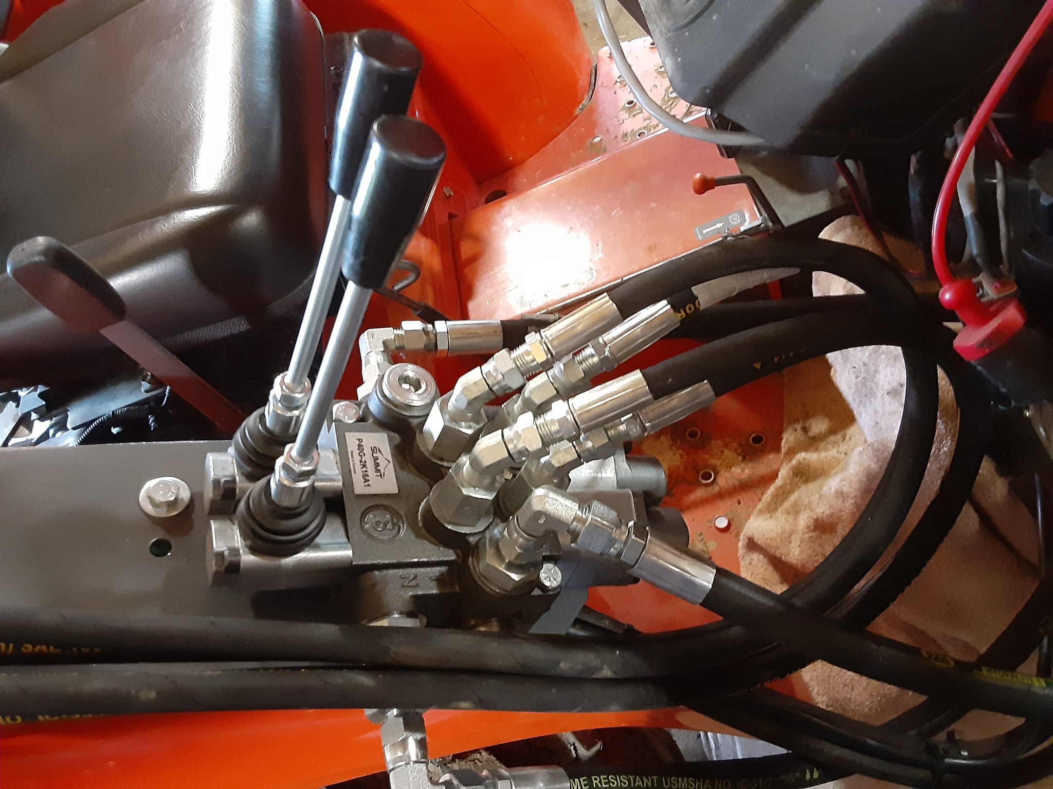

Naw I "pieced" it together with some help from Old Hokey and other threads on here. The top link and 2 spool valve came from Summit, fittings from Amazon, and another online warehouse, and one hose was made locally. I'm still on the lookout for a tilt cylinder that doesn't have the lead time of fit-right. Might just do what others have and build my own.
I put together my own T&T for my L2501, no QH. I used a valve from summit that had float in both. It helps me if I put them in float to level a back blade or rake on the garage floor before I take it out. I glued a 2 way level vial I got at lowes in one of those HF magnetic bolt dishes. That is always on the fender handy to stick on the implement to set the top cylinder. The tilt cylinder I welded up myself to match the adjustable link.
Thank you. I'll look into it. The price is tempting, but I don't need another project to figure out right now. That's why I was looking at the whole kit from K. Time or money.....when you have one, you don't have the other. Lol!!

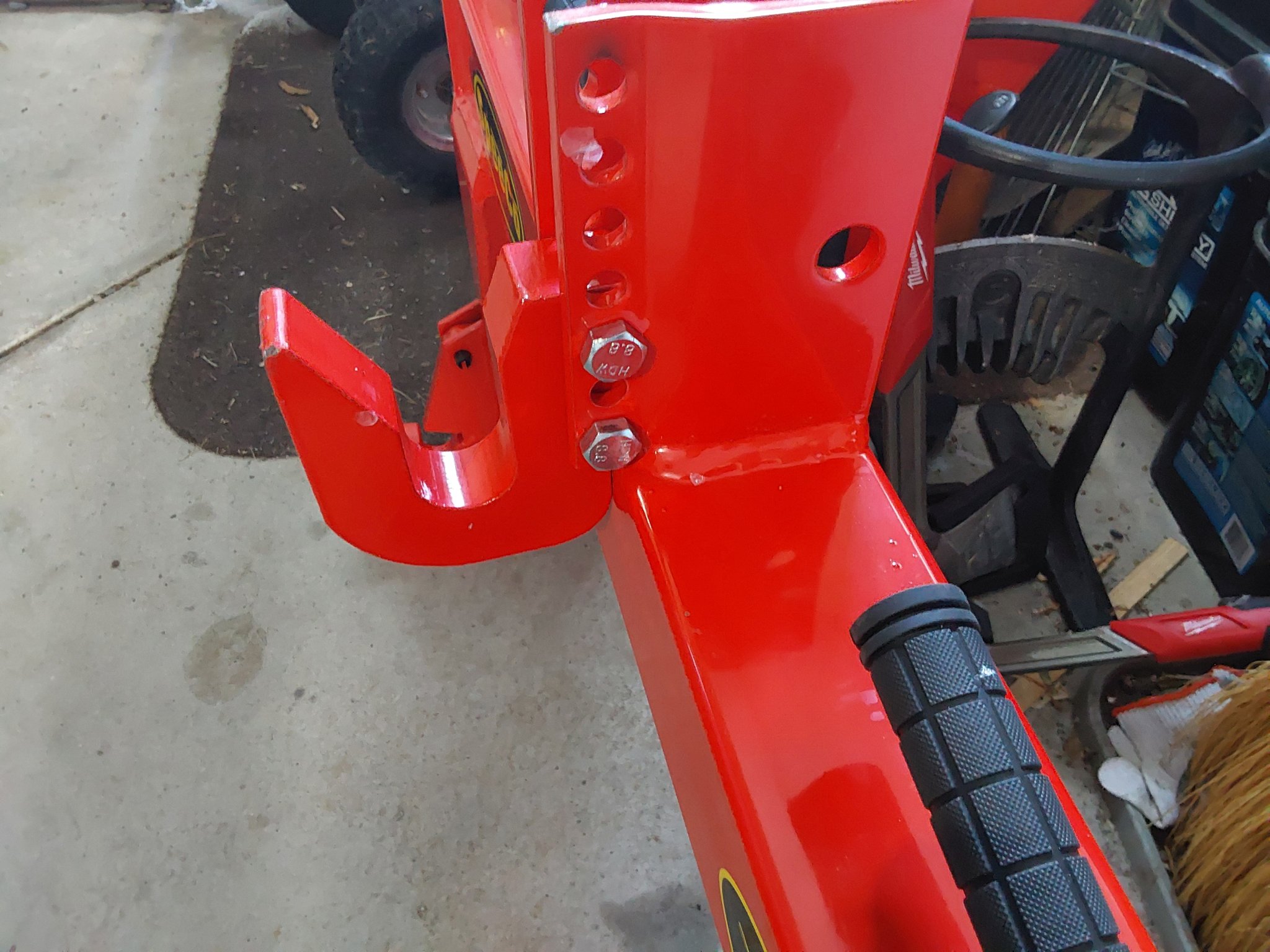

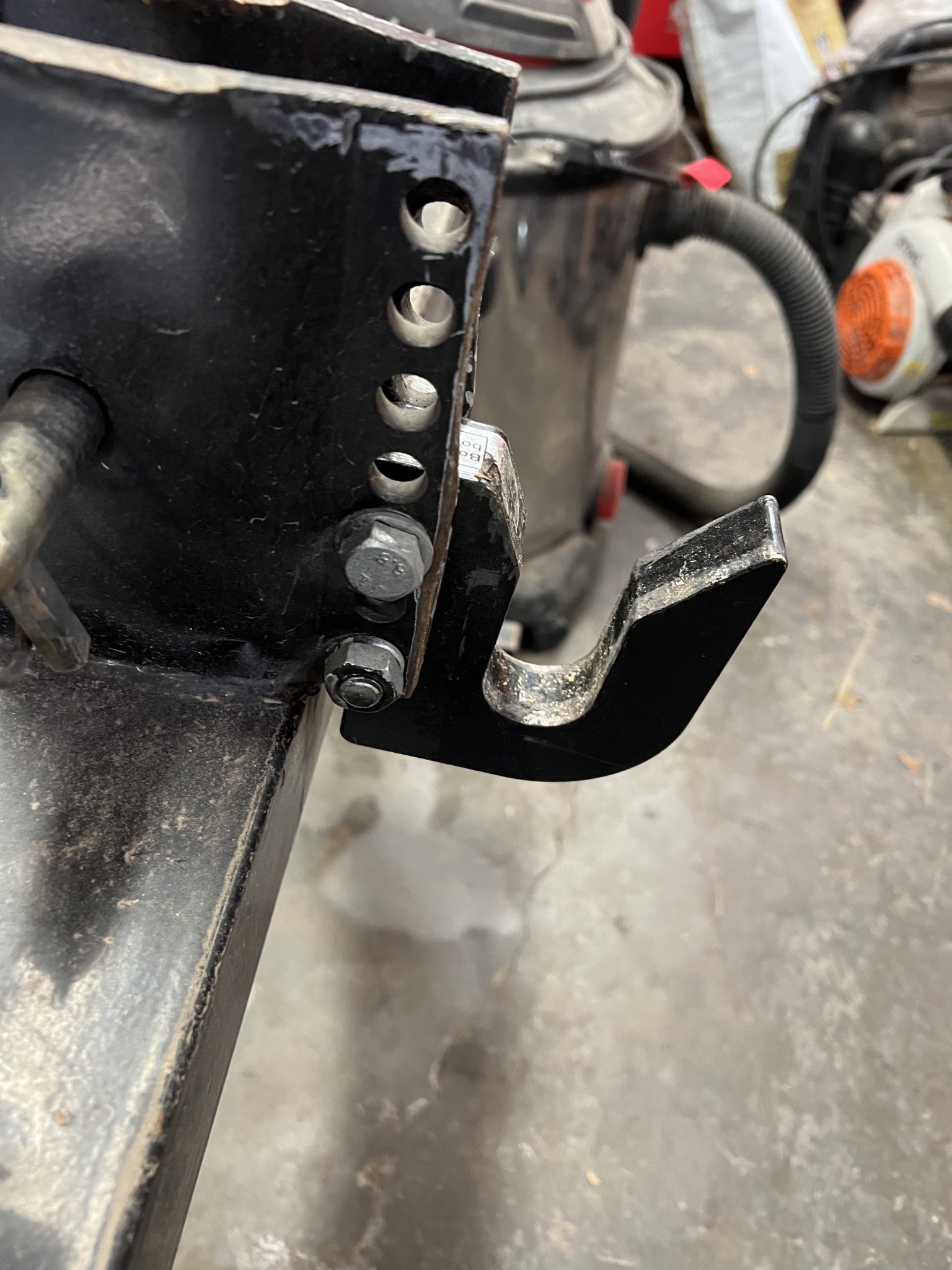

Just wondering what the extended hook gains? My hook sticks out 3/4" from the top frame and that Kenny's one is about the same from what I can find. I'm thinking the hook may need pins with removable clips instead of bolts.
12,735
5,535
Don't have one ( no need) but 'extended' may change the 'geometry' of how it hooks up to the implement ?
Sometimes just a little change in a part makes a world of difference
The position of your top hook looks similar to the one on my QH15. Yep, pins are definitely easier to deal with than bolts. The QH15 came with the pins shown, and I swapped them out for bolts thinking that I didn't need to move the hook around, but then swapped them back when I realized that wasn't the case.

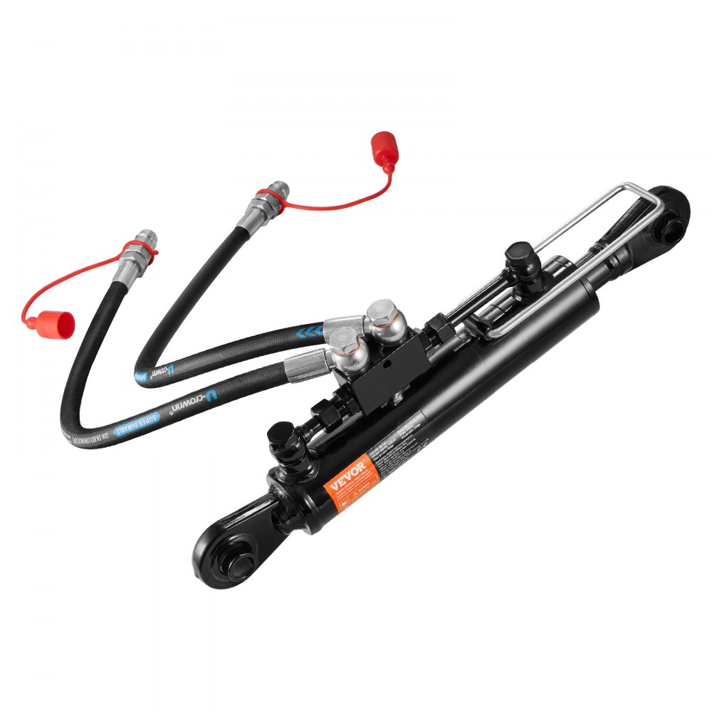

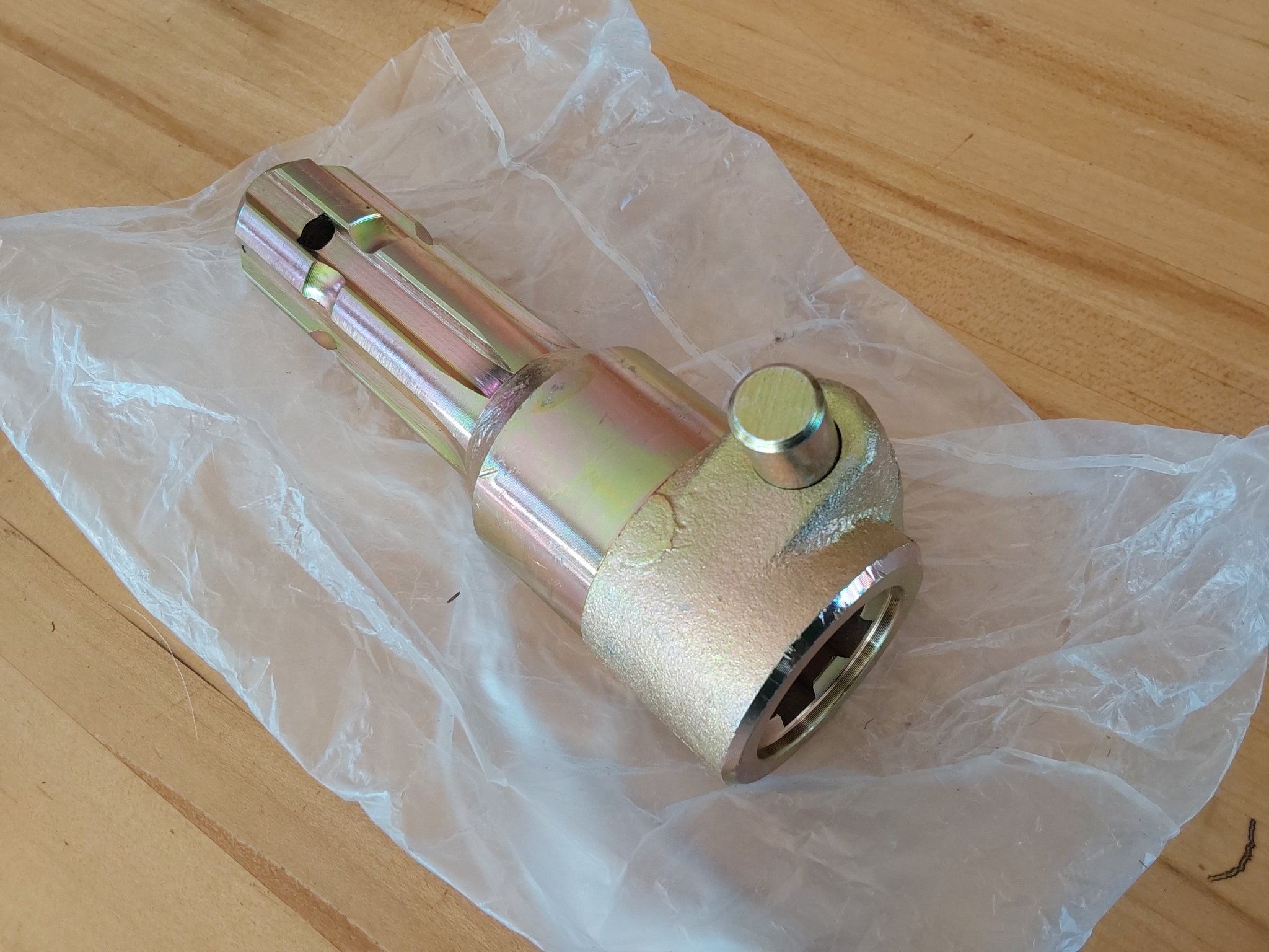

Got the extension for pto shaft and hopefully I am all set now to get started when the weather warms. Cheap Amazon one that had good reviews.
Found the Vevor top link comes with the correct quick connects for my remotes but the link length I need is sold out. Should be back in stock next month. I see many are happy with them and the only problem seems to be the hydraulic hose seal washers can leak on the right angle swivel that goes in the locking block, but a good set of replacements is cheap. Same setup is available from Holland with 3 day air freight but I'd rather wait and buy with a 1 year warranty.
Sure seems to be a lot on unnecessary plumbing on that. Mine just has 2 connections attached to the cylinder body that the hoses attach to.
From what I understand you need that lock block so you can't damage the tractor hydraulics. With an implement even just bouncing going down the road without that you can put 10,000 psi or more on the hoses and valves. That isolates the pressure surges and locks the cylinder in place.
Interesting. Mine was a Kubota kit installed by the dealer. It doesn’t have a lock block.
Maybe what I read on the internet is wrong 😲. Could it be that bigger tractors have stronger hydraulics?
I have an lx2610 and bought my top link cylinder from land pride. It doesn't have check valves. The check valves are nice as they hold the set position. The theory of the over pressure would be the same for loader cylinder as well and I haven't seen the check valves on them.
IDK. I was just surprised to see the check valves on the cylinder that you have.
I have both toplink and tilt cylinders. The toplink seems to hold position, but the tilt cylinder will bleed down overnight.
What your experiencing is typically. Without the check valves it will leak down. The side link might be binding up the toplink enough so you don't see the bleed down or it's just that the toplink valve doesn't leak down that much. My toplink leaks down. You can add the check valves yourself if the leak down is an issue. For me it's not and I only bought the Land Pride cylinder because it was a guarantee fit. I'm getting lazy in my old age.
I guess my point is that not having the check valves doesn't mean you will damage your hydraulic system.
Now if you're bouncing along with a full bucket of material on the front end loader or an implement on the three point hitch, you have a change of doing damage to the tractor with or without the check valves. The damage most likely will be structural, like bent loader or three point arms.
You will learn if an extended hook is warranted quickly.
Hard to describe, but it will be evident.
I have 5 (?) 3PH implements, and can hook/drop all of them without leaving my seat.
I do sometimes need to leave my seat to make my manual top link the proper length to make things work the way I want them.
Your stock hook looks very similar to the extended hook I got from @Kennyd4110.
I think it gives 7/16” (?) added reach and the geometry of the hook itself is a little different. The Boltonhooks.com was a huge improvement over what I had but might be similar to your factory hook.
The one @McMXi looks to give better reach also.
Not sure I have a handy picture of the stock hook for my Harbor Freight HQ.
