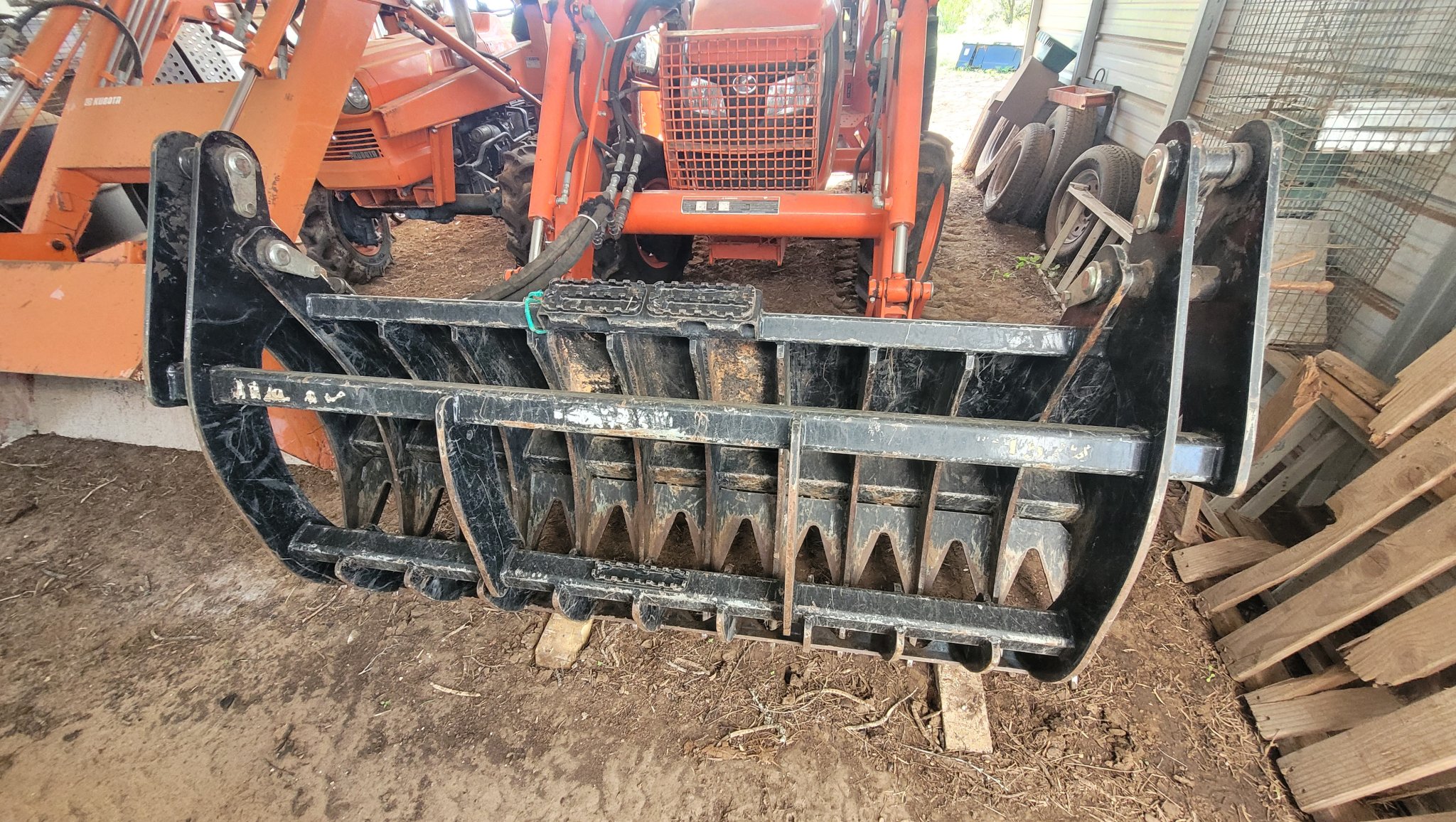

wow, I had to see a picture to understand WHY the HUGE weight. 800# is about the weight of a 4by8 sheet of 1/2 steel plate.
Looking at the picture you should be able to eliminate HALF of the tines for typical grappling duties like log or brush hauling. Does anyone know why so many tines ?

I like how solidly it closes. looks like it'll grip very well.
There is an old 3pt carry platform with rotted lumber in the woods. I'm going to look at resurrecting that as a rear ballast.
That grapple does not extend forward nearly as much as my root grapple so that should help some. I wish I had opted for a similar design
Landpride says its matched to M series machines so....

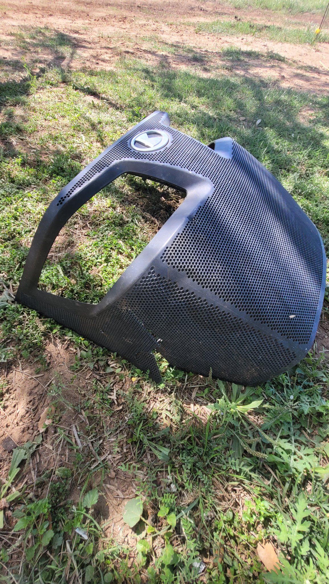

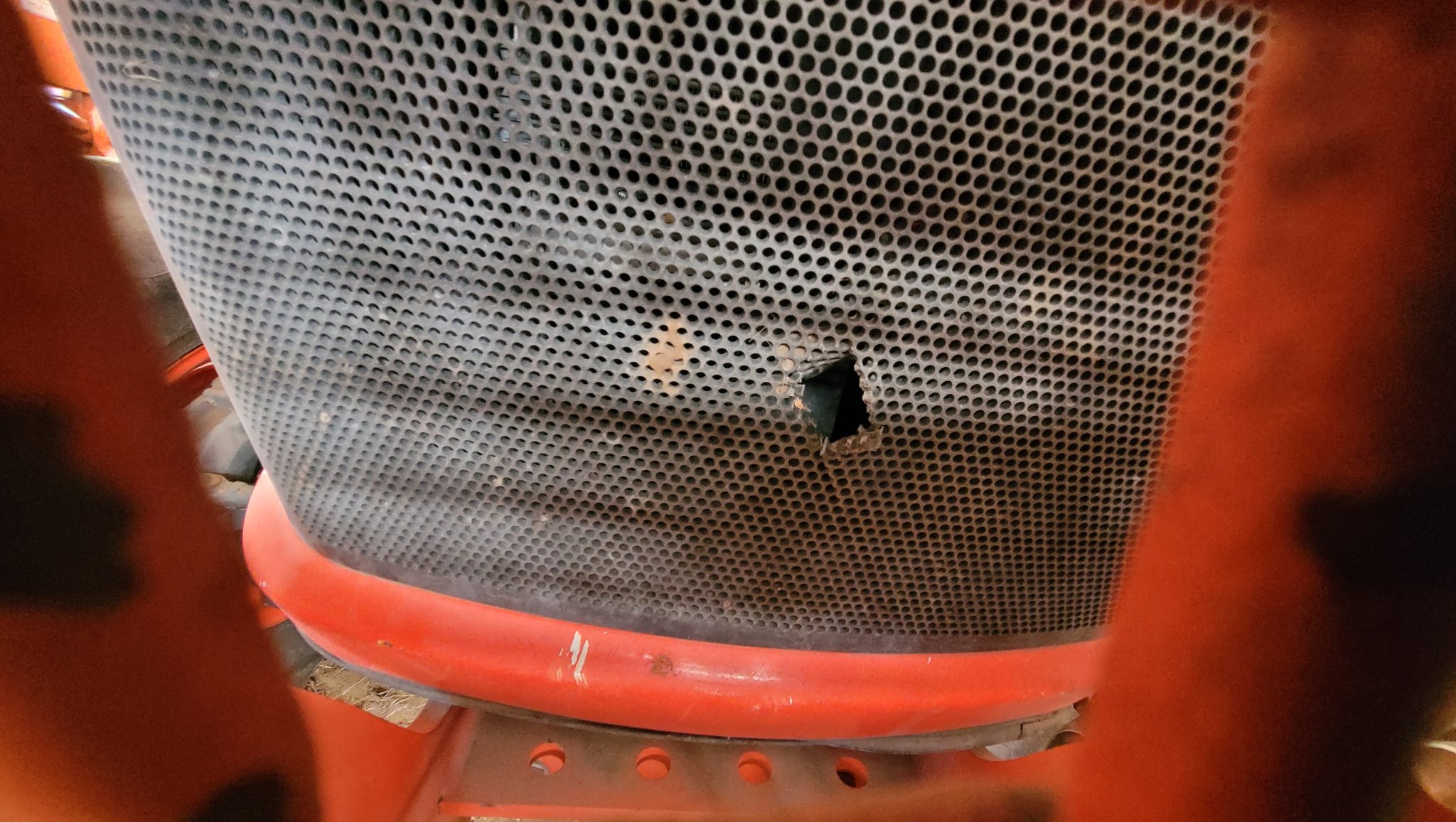

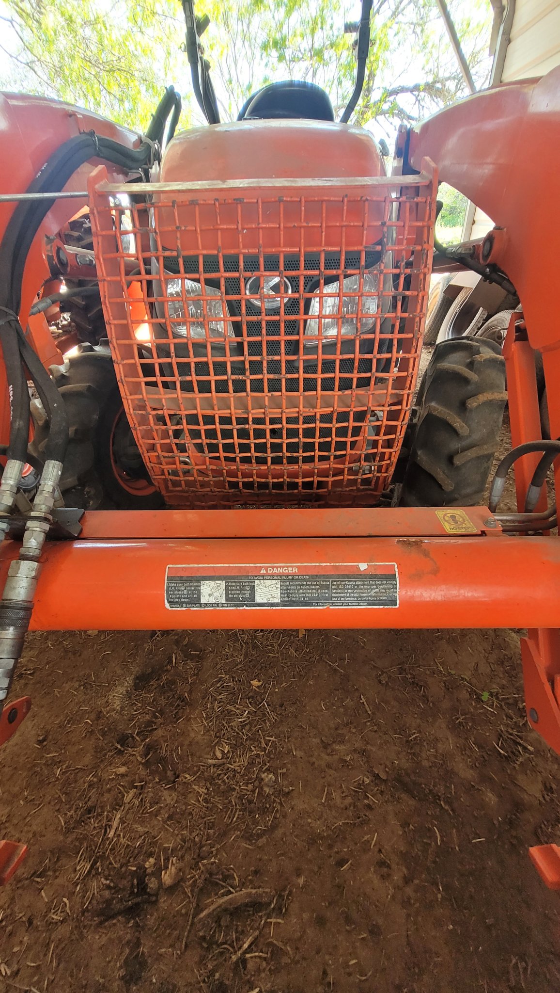

The 72" 900lb + is currently on my mx52, been moving heavy brush/tree cuttings off fence lines lately. If I'm clearing land, extended hoses get added onto the SVL and makes it easy peasy.
Reinforced 5/16 channel added to prevent stabs from pushing through.
Even with grill protection, and added plate to grapple, stabs will come through!
newer grill with hole
Old grill
