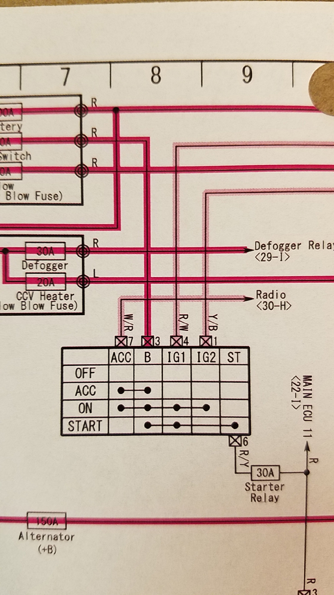

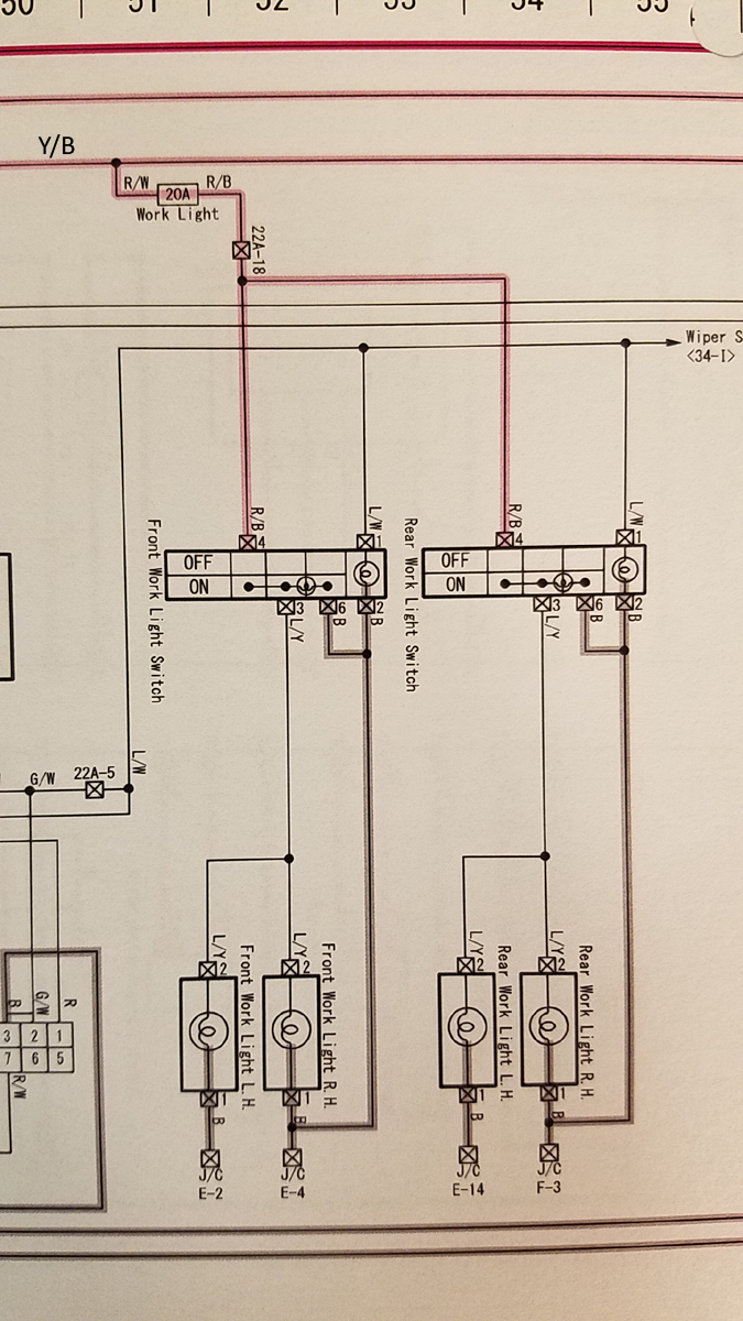

I have the WSM for the MX5400/MX6000 and maybe this wiring diagram will help you. I added Y/B to the second image to show which wire feeds the front and rear work light switches.
So it looks to me that the work light wire stubs are operated through the ignition switch and will only operate when ignition is on. Correct? Or am I reading the diagrams wrong?

No. But I’m thinking I might have a solution if the wiring is set up like I think. I’m not going to use the wires under the fender for the LED lights because I’m going direct to battery with relay and switch. If the work light wire ends under the fender are wired to ignition switch, I can use those for the USB port. Does anyone know if those wires are only hot with the ignition on?
Arent those work light wires only hot when the lights are on (ie switch)? You would have to have lights on to charge usb.
10,162
4,201
you are correct. power ONLY when key is on.
that's how you should power the USB port device. if you're not there,no dead battery.
Oh maybe that is true. I’ll have to check that out.
Yes, so the R/B wires going into the light switches would be good to either energize a relay, or if the current draw is low enough, supply the outlet directly. The work lights on my new tractor are on the right side B pillar near to the 12V outlet so I'll most likely use the R/B wire for a relay.

Well today I installed the USB charger and tied into the work light stub wires. It works perfectly: it’s hot when the ignition is on and off when the ignition is off. The lights don’t need to be on to power those wires, so I’m assuming that the Kubota work lights must be installed with a switch.
